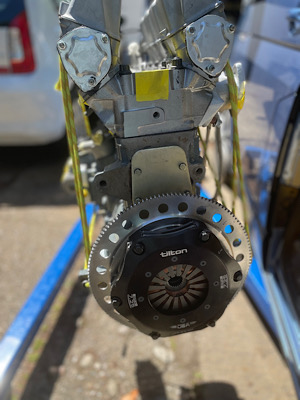

This is linked via a GC adapter and Tilton twin cerametallic hydraulic clutch to a TranX ally Ford type 9 race box leading to a Subaru/Kazz/AP suretrac diff .

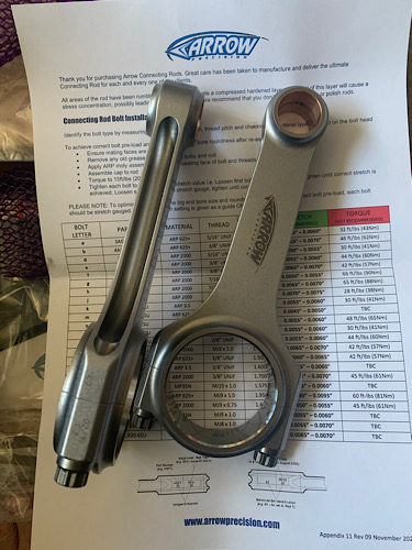

Sadly Gloria confirmed Cunningham are no longer in business so it was lucky I picked up these Arrow rods just in case .
- EADE0EAF-63FD-4BFC-8D93-F247BADBD80B.jpeg (77.17 KiB) Viewed 135525 times
- F3672368-06D3-4178-93BE-A09E3FE5053E.jpeg (40.76 KiB) Viewed 135525 times

In the search for a standard 2.0 crank I purchased a barn find Beta engine and box today but it turns out to be a 1585 so no good for me . Turns over freely so should be a good base for a rebuild for someone . If I decide to sell it on soon I shall list it here and on Betaboys .

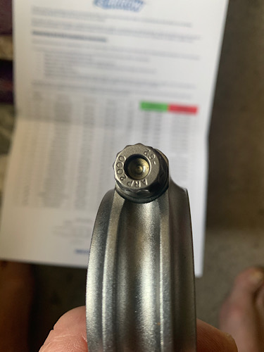

Absolutely love the Arrow rods, I bought a set for my vw golf mk1 turbo many years ago ( cars still not finished) and theyre a lovely item indeed, very well made.
Very expensive even back then in 1998, cost in the region of £1000 for the four but you just know theyll never break whatever you throw at them and theyre made in England too so have provenance unlike the stuff that comes from China.

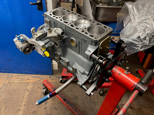

OE new block is looking good , Arrow rods , Ross pistons , Tri metal bearings , GC/Titan dry sump , race fly wheel , Tilton clutch all fully balanced .
The head I purchased from an internet auction site although well ported , CCK concluded a mismatch between the valve grooves and retainers and also valve tops slightly overground . They have now ordered new 47mm BMW inlet valves and new 38mm Ford V6 exhaust valves which they will marry up properly with the Isky valve springs and retainers .
Looking forward to seeing it all together , then up to Northampton Motor Sport . I will post as things progress .
CCK also have my second new block and this will be used to rebuild the ‘ rebuilt ‘ 130tc Strada engine I purchased with the re ground 2.0 crank . Several bits I have left over will be used on this build including higher compression new pistons , adjustable cam wheels , 1” belt , new lightweight flywheel etc . I will be looking to sell this on if anyone is interested ?

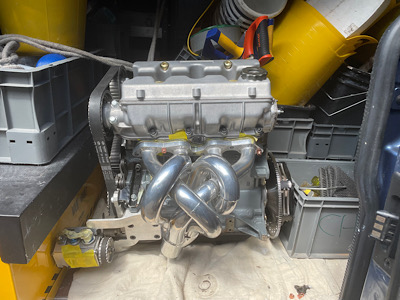

I should have posted that Debra and myself picked up the CCK built engine a few weeks ago .
I am now in need of selling my rebuilt 130TC Strada engine to raise the money to take it up to Northampton Motor Sport for Omex set up , run in and dyno .
The 130TC is on an internet auction site and the sale includes a brand new 2.0 block and crank , HC pistons and a manifold for twin DCOEs .
