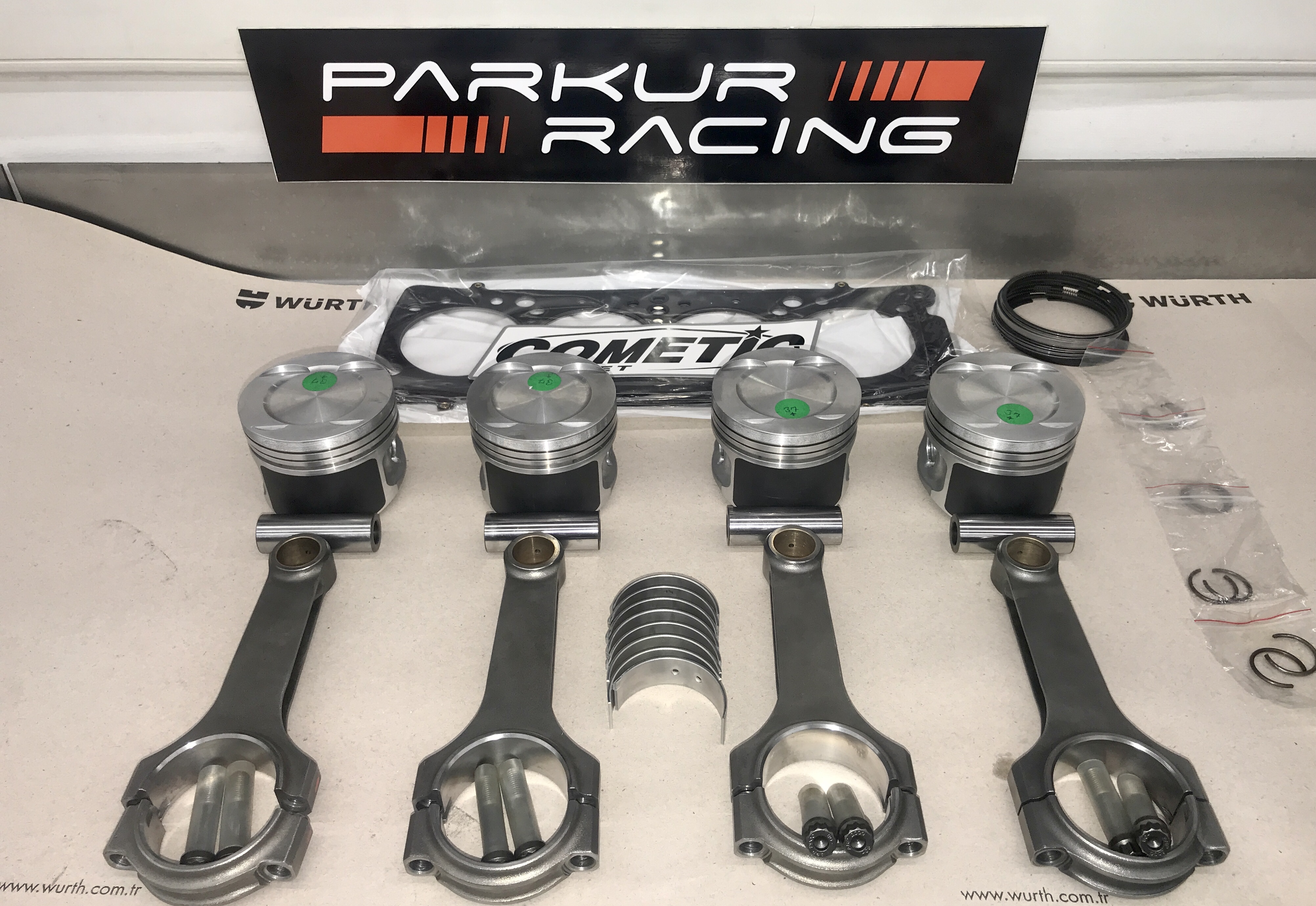

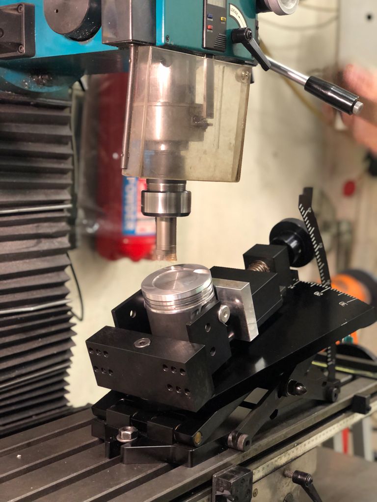

I have completed the built and the engine is on the car now. It has got a trigger wheel set up which I have to finalize the ignition mapping and I have to change the inlet manifold. The one which came with the engine is for TBs and the angle is too steep for the DCOEs.
Since I have built this engine ( customer preference for the time being ) with standard but modified pistons ( for slightly higher CR ) I couldn’t get 11:1 CR. And may be 11:1 CR with 95-97 octane with these cams would not be suitable anyway.
