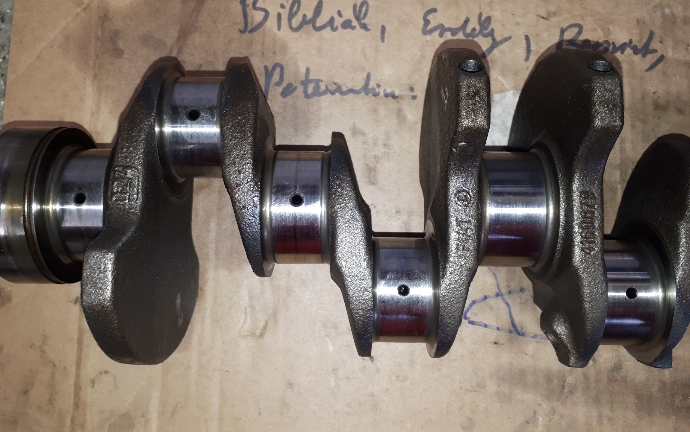

the 124 AC crank, can you publish a high quality (not monster gigabyte) photo or two please?
I am interested in the crank webs only, I need closeup - from this I can tell you if it is a forged steel item or cast...
Either way I shall comment and you should listen to my comments carefully please.
I have never had one at my works, only 1608 units, sorry..

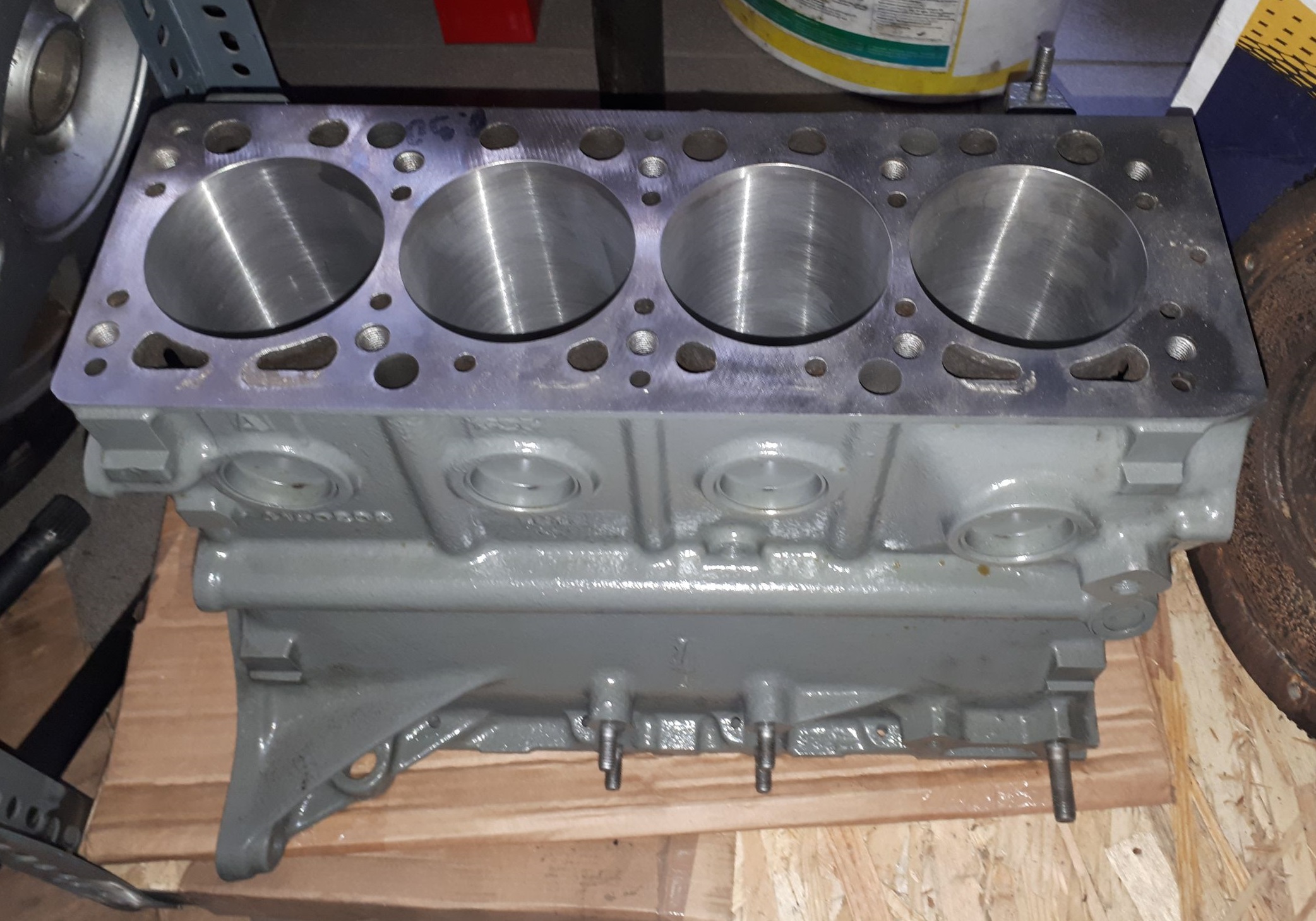

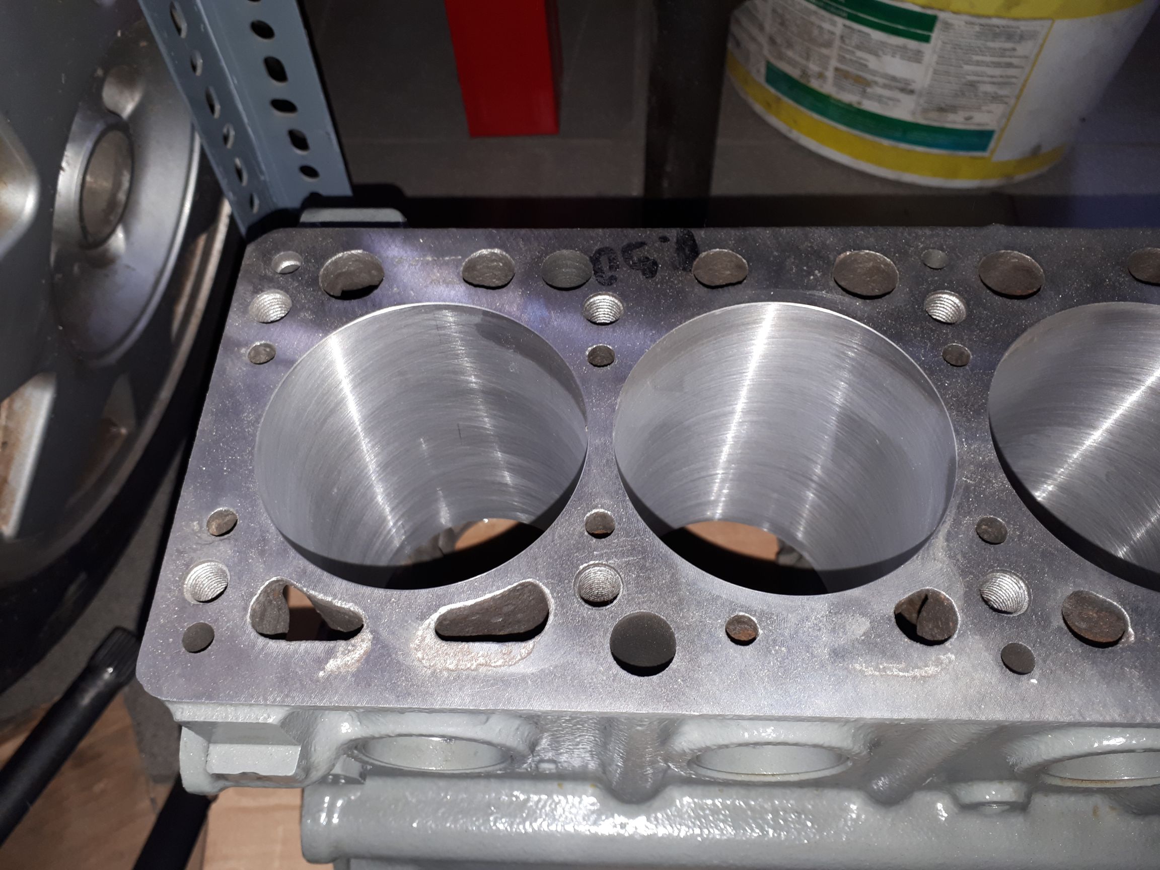

Re: Fiat 124 SC "Gruppe 5" race engine preparation
Mr croft.
After a long time, i can make the pictures.
I made some pictures of my factory crankshaft, and the engine block with 81mm bore.
Best regards
László Skripeczky
Best regards
László Skripeczky
