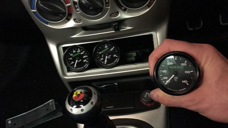

I had a omp steering wheel off my old hgt which I fitted
On to the instruments, Racetech gauges which I am sure Guy will approve of, very easy to install as they are mechanical so no wiring, oil and coolant temperature, oil pressure

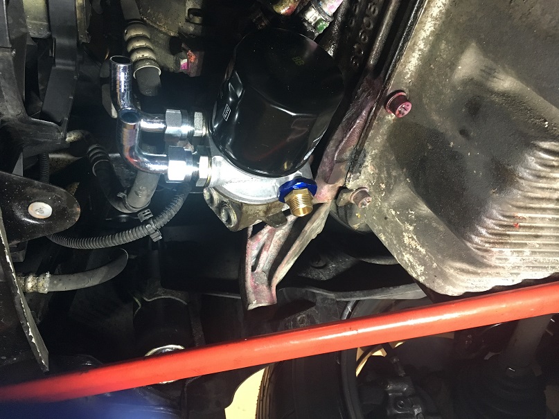

the oil temp I will fit into the mocal sandwich plate, I cleaned it up with some jizer brake cleaner before fitted (after this picture was taken)

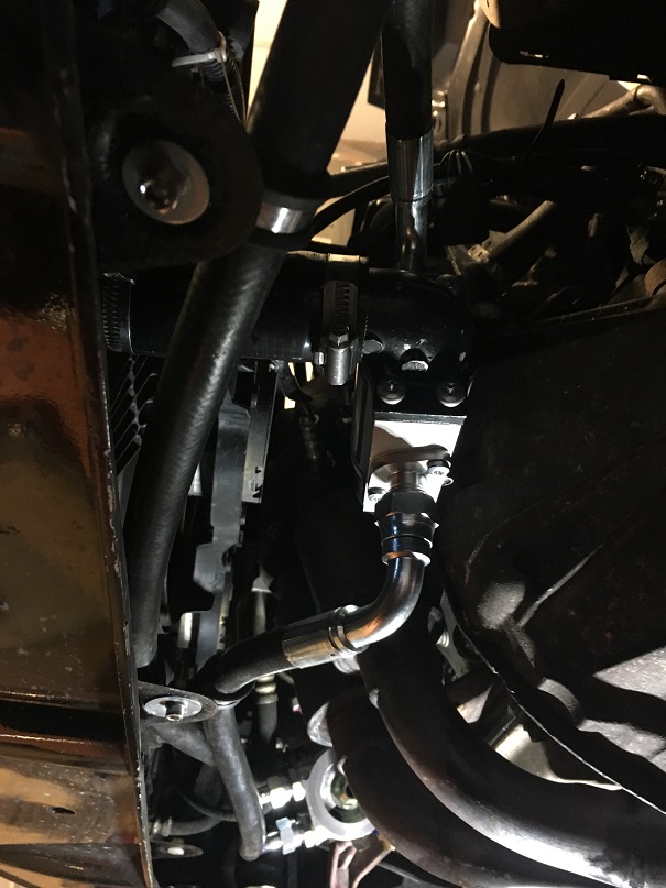

I had a mocal laminova left over from my uno turbo which i didn't end up using so it will be perfect for this punto, it is the smallest size so equivelent to a 10-13row air to air oil cooler, I decided to fit it into the lower radiator hose due to the shape of the hose meaning it was a easy fit, the oil lines I used mocal 1/2" 100r6 hose with 1/2" fittings from Think automotive.
the hgt uses a oil/water heat exchanger which I removed and in its place a mocal sandwich plate with a m20 extension bolt, the original (new) oil filter still fits
oil lines fitted and secured with rubber lined p clips, the aim is to keep the oil temps below 85-90 degrees.

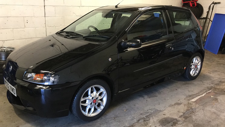

This is currently how the car looks, Trackday is booked in December at Oulton Park circuit.

The only observation I would make is that I would never use push-on rubber hose and clips on oil lines. It's just too risky. I've seen them leak and blow off, same goes for fir-tree push-on hose and swivels.
I've tried all the different methods and the only one I recommend is Mocal 100R6 stainless-braided with crimped-on swivels. Think Automotive make this up at their works. Always fit one straight swivel to any hose (the other end can carry a straight, 45 or 90 deg swivel) and following this rule prevents the hose from coiling up when you fit it.
