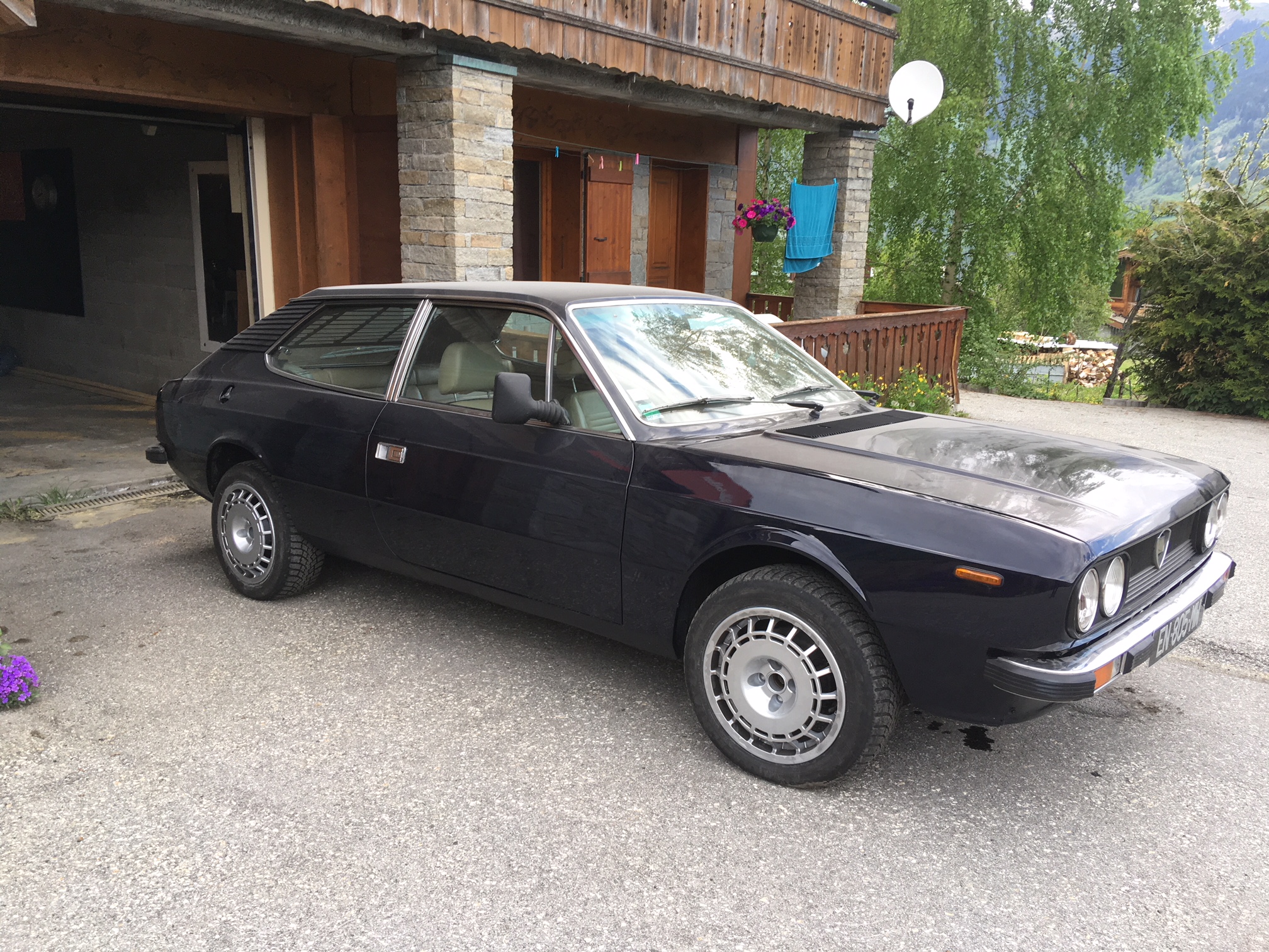

Hello Guy, hello everyone.
I am new here, my name is Pierre, I am french and the proud owner of a 1979 beta hpe 2000, completely rust free. I have been restoring my car ever since I bought it a year ago. Even though I drove it away from the seller's house, it still needed a lot of love, especially chassis wise. With the help of a well known Lancia parts supplier (not sure if I can name them?), I was able to source and restore all suspension components and bushes and it is starting to drive like I've always wanted.
Being a normal man, I need more power now ! So far the engine is completely original and has been very well looked after by the two previous owners and myself. It is very healthy and spits out 10.5 to 11 bars on all four cylinders (not sure if you guys talk in bar or psi...?). Still, living in the steep mountains of the french alps, I often find myself waiting for the power to build up coming out an uphill hairpin. As GC and many of you probably know, the engine in original spec is very torquey and quite enjoyable to drive for everyday use, but it does lack a little bit when the road opens up, especially now that it is starting to drive like a stiff go kart with close to zero body roll. I have always wanted to fit my car with the twin DCOE from a 130tc but I quickly found out the distributor would be in the way, hence its placement on the ritmo, at the end of a cam shaft. Also, I wonder if it would have actually made any difference whatsoever once mounted on the beta's original head, with its original valves and camshafts. Most likely even more fuel thirsty but power gain wise, I am not sure... Now, I do not mind swapping the whole head for a 130tc head but I always thought I could be entering the danger territory of possibly longer valves and pointier/bigger cams making my Lancia pistons come in contact with the ritmo valves... Since I do not have the answer to this question, I even considered swapping the whole engine (found a really nice 130tc engine for sale in italy), but then I read this post of yours :
viewtopic.php?t=1269
Here is my question: I am now starting to wonder, is the bottom end + flywheel + pistons of an original spec 130tc that much better than the ones of my current beta engine, or do you think the whole engine swap is too much of a hassle when a head swap is possible and the only thing really worth doing along with the 130tc exhaust manifold, multiplex ignition and baffled sump ? I have read what GC said about the ritmo camboxes being designed to drain oil at a certain angle, so I guess I shall keep my Lancia camboxes no matter what but would the 130tc camshaft fit in them ?
Again, I do not wish to make a track weapon out of my car which is currently my daily driver. Of course I could go all out with forged pistons and a GC competition head or even a delta hf engine, but it is not really part of the plan. I just wouldn't mind the engine to be a little bit more "rev happy" if you know what I mean...
I would much appreciate your point of view about my situation and I would be very grateful if you had the answers to my questions.
Thanks in advance to you Guy or anyone else who has ever been there before.
Pierre

- Of course it leaks a bit of oil ! It is fixed now though
- IMG_2573.JPG (1.37 MiB) Viewed 138565 times

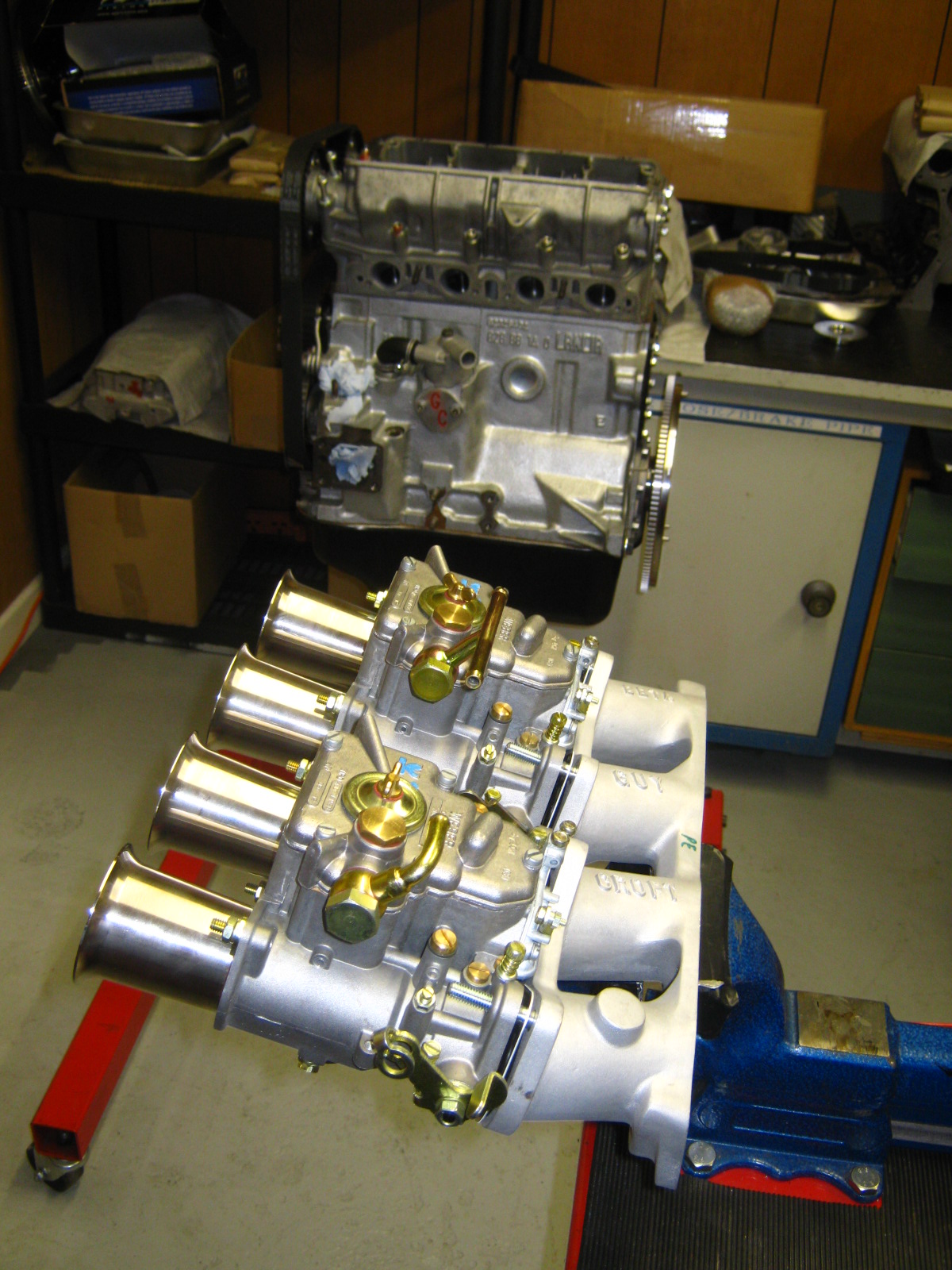

Good evening Pierre & all..
my replies in CAPITALS for speed..
Thanks for the quick reply. Of course it doesn’t fit, would be too easy ! What do you mean by valve relief ? Is that the dug outs on the pistons ? In which case I guess the Strada head only works with Strada pistons, which is a bit of a shame in my case. By the way, was the Ritmo called the Strada in the UK ? Never heard of this name before.
YES VALVE RELIEFS ARE THE CUTOUTS IN THE PISTONS..
THE RITMO 125TC WAS SOLD AS THE STRADA 130TC IN UK..
I find it very interesting when you say that 40 carbs are a bit weak for a 2l engine since they are the ones that originally came with with the 130tc. Did Fiat deliberately sold their ritmos mounted with 40 carbs despite knowing that 45s would have made for so much torque improvement?
Anyway, what should I expect if I were to install some 45 DCOE on my fully original beta 2000 ? Would it actually change the engine behaviour by a lot, despite keeping the original valves, cams, fw etc..?
IT IS POSSIBLE THAT THE STRADA 130TC WAS MARKETED WITH 40 CARBS BECAUSE Fiat HAD RECENTLY BOUGHT WEBER AND SOLEX AND MAY HAVE INHERITED A WHOLE LOT OF 40 CARBS. EVEN IF THAT WAS NOT TRUE THE ENGINE DEVELOPED ENOUGH POWER & TORQUE ON 40S TO BE GREAT FUN - EVEN IF USING 45 CARBS WOULD HAVE GIVEN WAY MORE..
Also, that intake manifold that you talked about, does it go around the beta distributor? And are the carburettor’s trumpets still able to suck some nice and cool air despite being right behind the upper tie bar ?
YES MY BETA 2 LITER INLET MANIFOLD IS OFFSET TO CLEAR THE DISTRIBUTOR. AS FOR THE TIE BAR I DO NOT KNOW. THE STRADA AIRBOX SHOULD BE RETAINED IF POSSIBLE IN THE BETA ALTHOUGH THE HOLES WILL NEED TO BE ENLARGED TO 45 BORE. EASY TO DO WITH A DIE-GRINDER AND ABRASIVE. WILL THE REVISED LAYOUT CLEAR THE RADIATOR? SORRY I DON'T KNOW FOR SURE. I DON'T WISH TOMAKE EXCUSES HERE BUT OFTEN I WORK ON ENGINES WHERE I HAVE NO CLEAR UNDERSTANDING OF THE UNDERHOOD LAYOUT AND RELY ON THE CLIENT TO WORK IT OUT HIMSELF. I THINK YOU MAY HAVE TO MOVE THE RADIATOR OVER A BIT..
BASICALLY YOU HAVE TO FIT THE MANIFOLD & CARBS, AIRBOX AND WORK IT OUT FROM THERE..
WOULD IT BE BETTER TO USE THE RITMO/STRADA ENGINE? I CANNOT SAY. SO MUCH DEPENDS ON THE CONDITION OF THE ENGINE. MOSTLY I ASK FOLK TO SEND THE ENGINE TO ME FOR GC SPEC REBUILD BUT THEY NEVER DO! THESE ENGINES ARE SOME 33-40 YEARS OLD NOW AND DESERVE BETTER TREATMENT THAN SIMPLY BOLTING PARTS ON TO GET MORE POWER....!
IF THE ENGINE IS NOT 'UP TO THE EXTRA POWER' YOU BASICALLY WRECK IT ADN GETTING ANOTHER THESE DAYS IS NOT EASY! THE BETA IS ESPECIALLY AT-RISK AS IT HAD THE WORST SUMP EVER IN THE WORLD AND BEARING PROBLEMS WERE VERY VERY COMMON. YOU CANNOT SIMPLY USE THE STRADA/RITMO SUMP AND PUMP - THOSE ENGINES WERE MOUNTED VERTICAL - THE BETA IS MOUNTED WITH 20 DEGREE ANGLE..
I DO MAKE MARVELLOUS RACE SUMPS FOR THE BETA BUT CHECK ON CRANK BEARINGS IS VITAL!
HOPE THIS HELPS A BIT MORE..

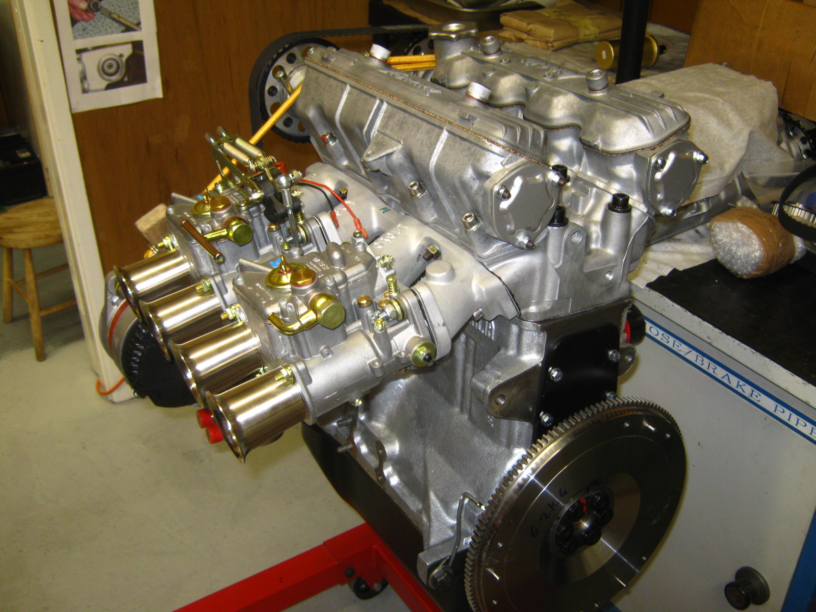

The rebuilt engine will potentially be very good on twin Weber 45s!
A lot depends on the quality of the rebuild and the exhaust system! Don't place too much hope on old silencers and if you get new ones make very sure they are to OE Lancia spec.
It will be important to build a sealed cold air intake for the carbs. Otherwise they will just suck hot air from the radiator and rob power and cause detonation.
Jetting:
mains 145
air correctors 185
pump jets 45-50
idle jets 45
chokes 36mm
emulsion tubes F16
