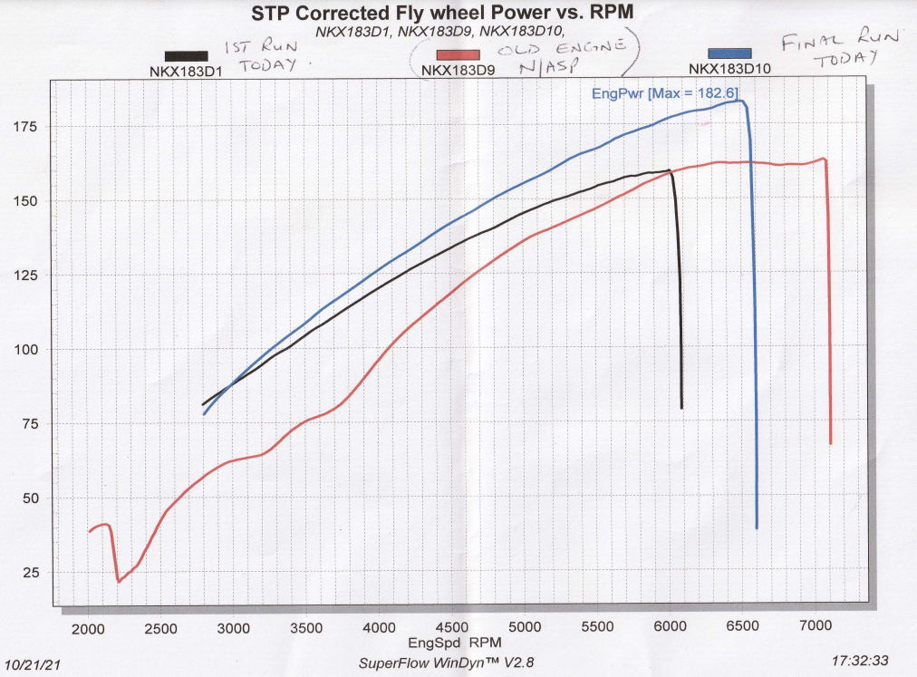

After a number of false starts including a blocked fuel line and a leak on the inlet manifold, I have finally got my new Volumex engine tuned on the rolling road.
The results are a little bit mixed with some good results but just a tinge of disappointment that the engine fell quite short of the 200hp barrier.
So first is the initial run (black line) vs the final run (red line), achieving just over 182hp at around 6500rpm. This was somewhat short of the 200hp that I had been hoping to achieve. Interestingly, and against the established practice, the first run was on 28mm chokes and by the final run we were on 34mm chokes as the car wouldn’t respond on the 28mm chokes at the higher revs. Though you will notice it does “bog down” below 2500rpm. This was after multiple changes and tweaks. It is also running quite big fuel jets at 215 mains. What is satisfying is the torque curve, which as expected with a supercharged engine, starts at 150lb-ft peaks at 165.9lb-ft basically doesn’t drop below 150lb-ft.
RR Map 1.png (1.15 MiB) Viewed 174336 times

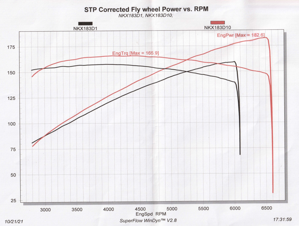

The second map shows the true advantage of the supercharged engine over the normally aspirated. We have the initial run (black line) and final run (blue line), as before, but this time the red line represents my previous GC engine that was normally aspirated running twin 45 DCOEs. As you can see the power is just so much more available from the start and all the way through the rev range.
RR Map 2.png (1.18 MiB) Viewed 174336 times
The result is still an incredibly quick Morris Minor and awesome acceleration thanks to the high torque, but not quite the final power I was hoping.
So some anomalies, such as why the need for the bigger chokes when GC always recommended smaller chokes.
Do I look for the extra HP? Could get a smaller drive wheel for the supercharger and spin it faster. There could be some problems in the drivetrain as I know the gearbox has some damage from a previous incident. Alternatively the engine is still very new so it might benefit from further running. Another possibility is the supercharger (although rebuilt) is falling a little short.
Unfortunately as I can no longer ask Guy I’m just going to run the car and enjoy it for a while.
