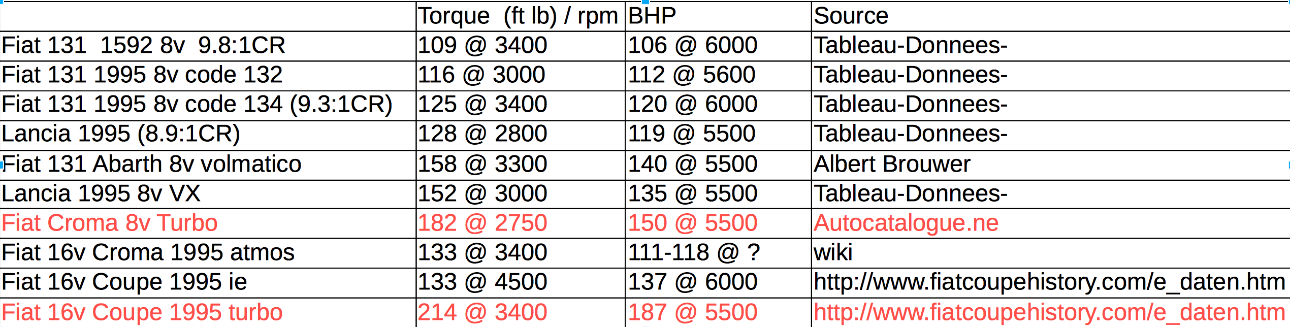

I 've listed the possible donor alternatives as fully as I can find fro my hospital bed and I can see sources differ slightly

Summary:
16v although 13% less torque than any supercharger, it has nearly the same max bhp
A turbo on both a 8v and a 16v get you close or over 100bhp per litre and ft lb torque
Stock Lancia 8v 1995 outperform on torque and bhp all Fiat 8v except the 134 engine codes when they are the same
Lancia 1995 8v VX – with slightly different Lancia produced head the smaller supercharger has the same bhp but 14% less torque than the 15psi Volumatico
but maybe spinning faster as I read that in GC posts the number of splines per revolution is smaller but the boost seems to be smaller
Fiat 131 1995 Abarth 8v
I understand it has bigger valves than std 42/36 – cannot find what size the Abarth is it similar to GC's 43.5/40? or whether they are even available as replacements anymore – ie Fiat part number In/Ex
16V onto a 131 I cannot see this described – any detailed information would be very interesting as it opens up the 16v turbo which I understand both the RS axle and 131 box can withstand

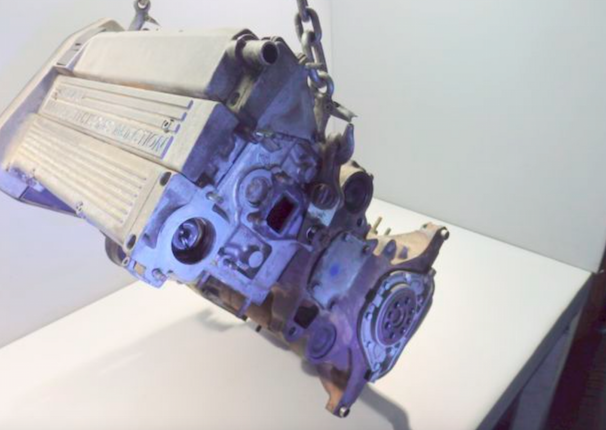

Here is a rear view (400kb ) of a 16v 1995 – and I again am not sure what is exactly involved with the various channels and connections to mate this to a 131 bell as it did'nt to look much the same as the rear of our usual 8V TC. I've highlighted two features I ve not seen on a 8V TC
The top one is the waterway which I think is the reason people use reverse 16v heads on 8V ?

I'll keep this simple for starters!
The only way to run a RWD 16v of the type you've indicated is to fit the 'late' Integrale/Tipo type 16v head to an earlier crankcase - eg 2L 131/132
The complete 16v unit - apart from being massive with its balance shafts cannot be married to a RWD 131 type bellhousing and gearbox. You can't get the starter motor on!
