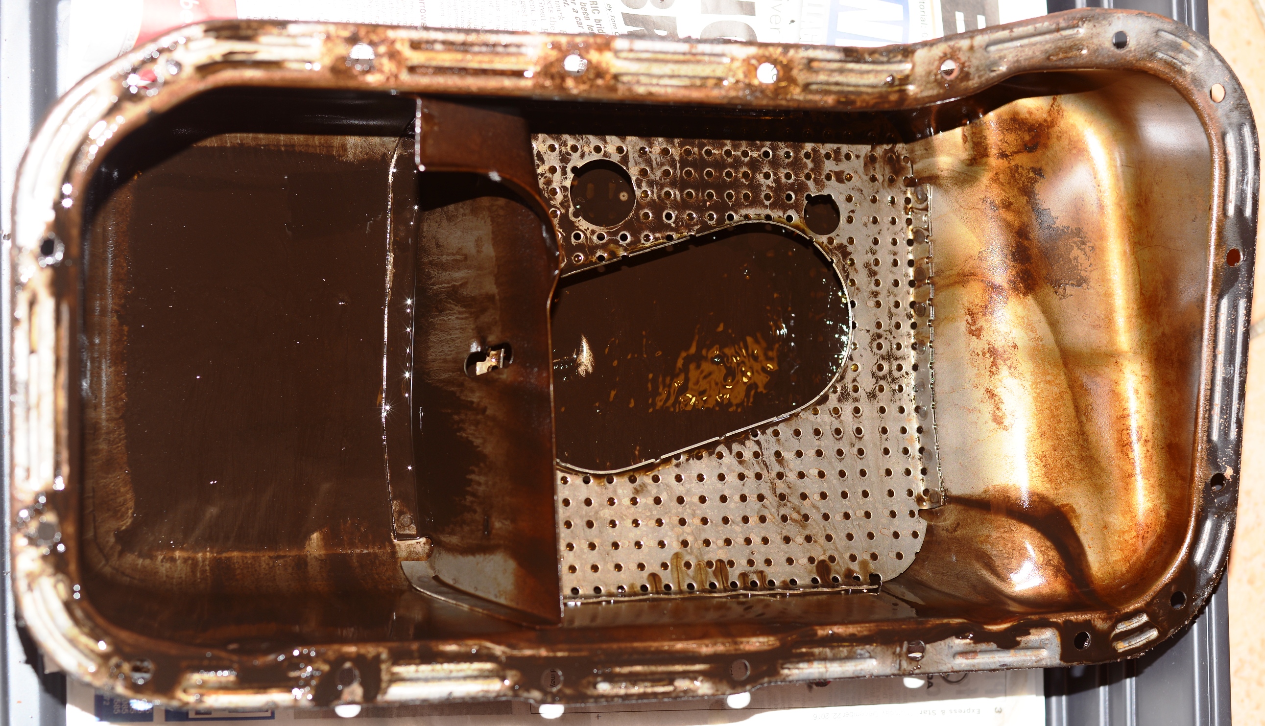

While reading through Guy's first Twin-Cam book, I chanced upon the Lubrication and Cooling section. In it there were several photos of Beta sumps, from which I deduce I have the later version of sump (not quite as awful as the earlier version, apparently). Guy's notes on this read 'Later model Beta pan incorporates modest baffle plate around pickup. If sump is being fully baffled, as described later, this is worth retaining.'
I am intending to fully baffle the sump, as per Guy's specification, but was wondering how much of the original (modest) baffling should be retained and how much discarded? Before I get stuck in with the hammer and chisel I really need to know what I should be doing.
Here are some photos of my (unpleasantly manky) sump pan and its internals:
View from directly above.
View from one side.
Do I retain the dimpled portion or the more upright portion with the curved top? Or should I just rip it all out and baffle it as per Guys specification?

I can tell you from experience that the sump shown is only mildly more effective than the other Beta ones that had no more than a curved steel plate by way of baffling.
I would cut out everything and do one GC style as per pics..

Thanks Guy. I rather suspected that would be the answer. To be honest it's probably far easier to dispense with the current arrangement entirely and start afresh, rather than trying to do a re-work.
