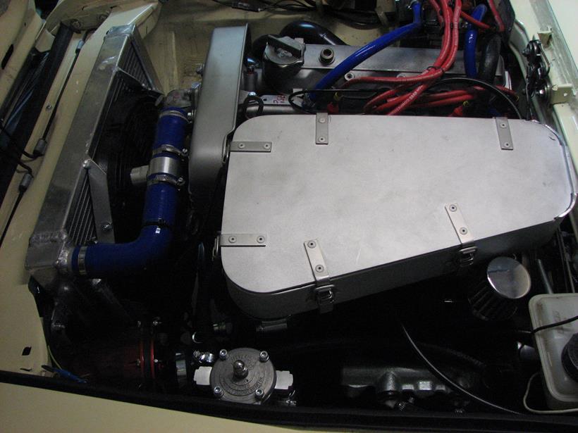

If I see it correctly you have a filter on the crank case breather located next to your air box. I think it will foul your pristine engine bay with greasy droplets so I would advise to route it to a catch tank or to the air box.

Ultimately, I'm going to install catch tank.

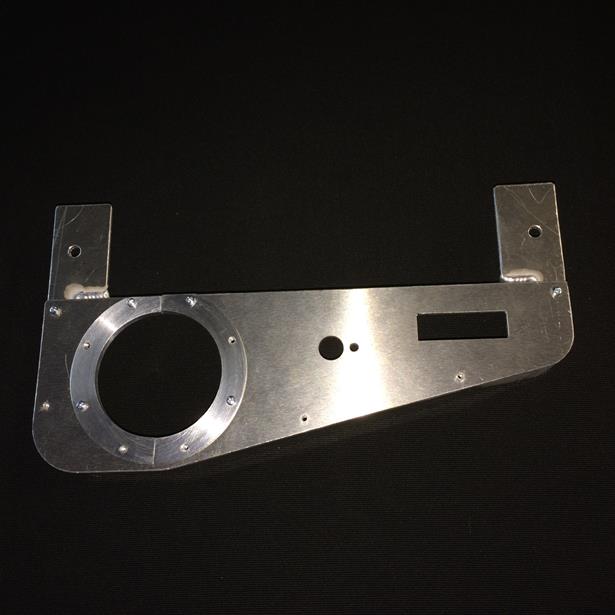

Below the fuse box is located indicator oil temperature.
There will be also installed Heater Fan Switch and Revotec Fan Override Switch.
Below I have attached photos of the panel to which will be attached additional equipment.
