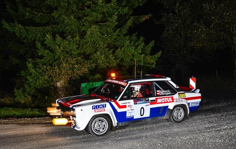

NEW (PHOTO) UPDATE
As regards benefits of 85-95 % of full torque high torque available from 3K RPM up to 7K RPM.
I recently rallied in the Polish Rally Championship event - going 18% up hill and - believe it or not - I was able to shift up to 5th gear and accelerate effectively from 2.5 K RPM !!!!!!
If you ever really rallied - you understand what this means . If you never rallied - it would take too long to explain .... In any case this is fantastic !!!!!! ( Note my diff is 5.375).
