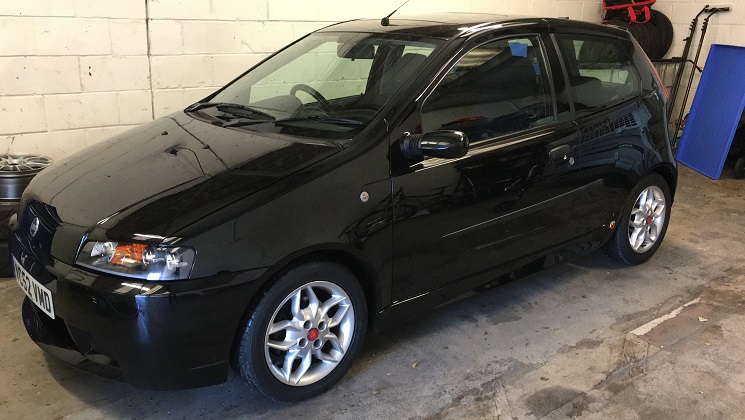

recently I managed to find this punto hgt which has a sound chassis with very little rust, the idea with this track car is only to improve the handling and braking, the engine I shall be keeping standard, I want to be able to learn how to drive fast on a track to eventually get into motorsport.
New hgt.jpg (123.24 KiB) Viewed 161146 times

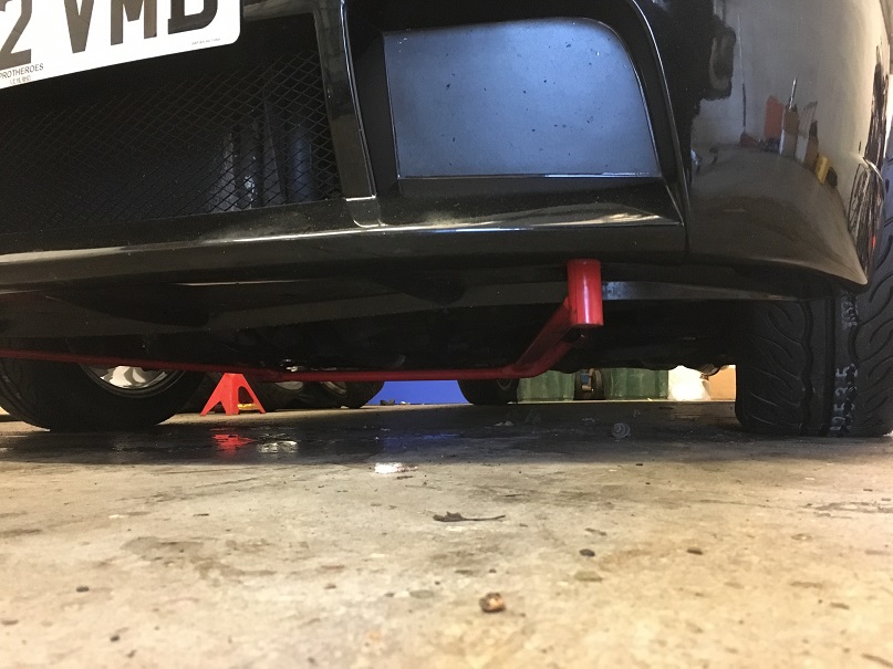

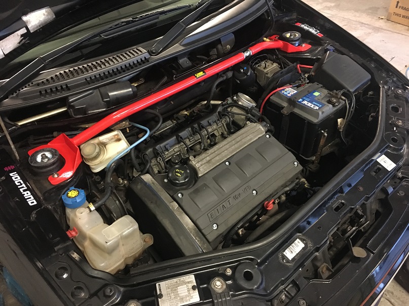

I had some omp strut braces from my old hgt which I managed to fit on, the lower strut brace is quite difficult to fit, the engine is a 1.8 16v vfd, 130bhp

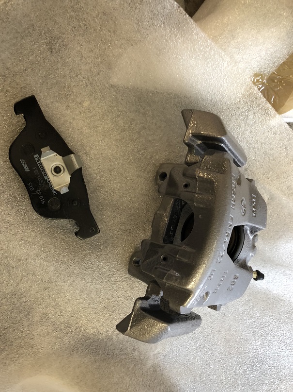

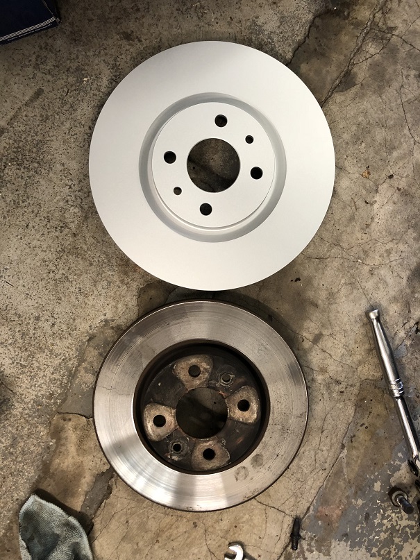

I wanted to upgrade the brakes a bit this time so I got a set of calipers off a mk2b punto hgt which uses a 284mm disc instead of 257mm,
brake discs.jpg (233.33 KiB) Viewed 161146 times
the calipers I immediatly sent them off for a re build and they came back as new, along with some new ferodo ds2500 pads and discs I fitted them on.
caliper and pad.jpg (228.23 KiB) Viewed 161146 times

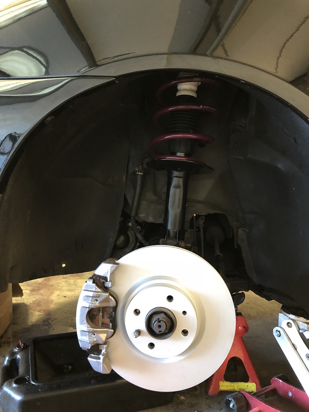

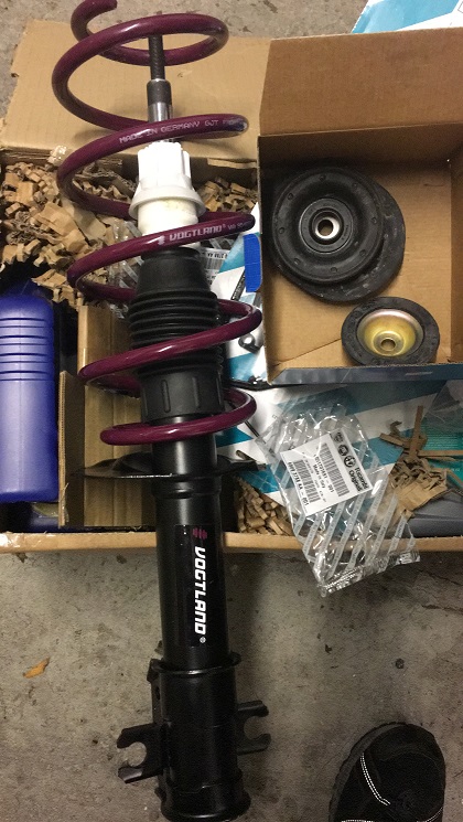

suspension I opted for vogtland springs and dampers which lower the car 35mm all round,
I fitted the suspension kit with some new top mounts and mounting cups

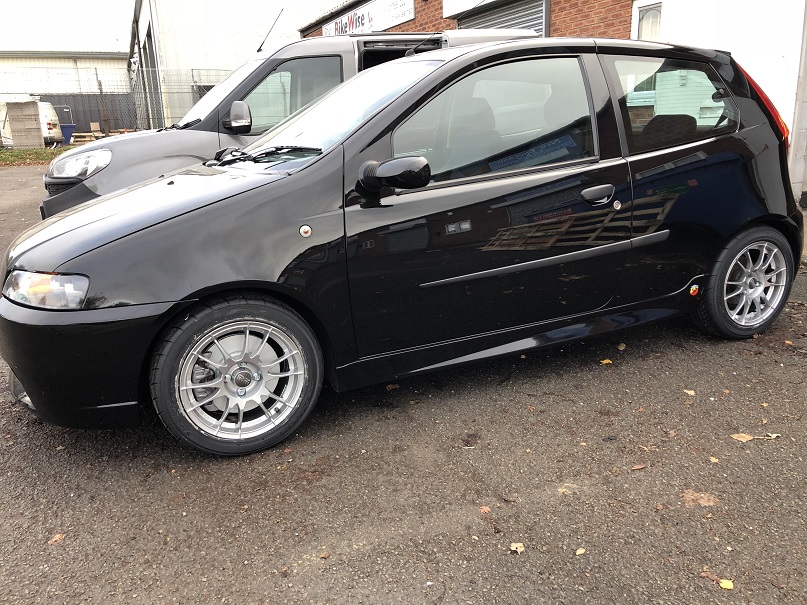

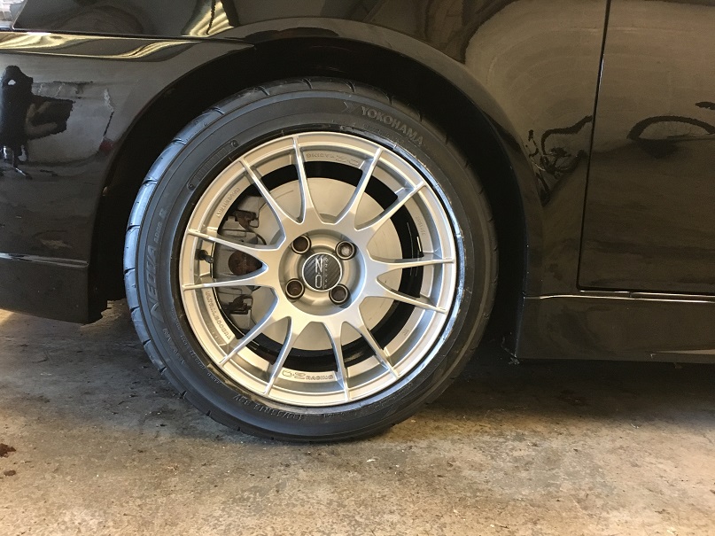

I had a spare set of O.Z Racing ultraleggera alloy wheels which I had some Yokohama AD08r tyres fitted, I have used these in the past on the Nürburgring and they are one of my favourite set of tyres, they offer a lot of grip once warmed up, I opted for 185/55/15 which is the same size as the original tyres so they are a perfect fit with no scraping of the rear wheel arches.
wheel on with tyre.jpg (195.93 KiB) Viewed 161146 times

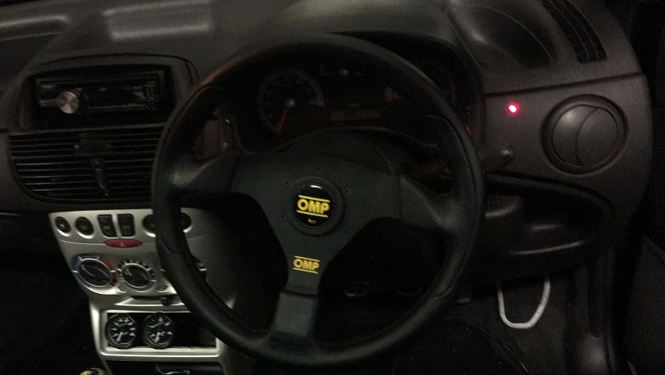

I had a omp steering wheel off my old hgt which I fitted

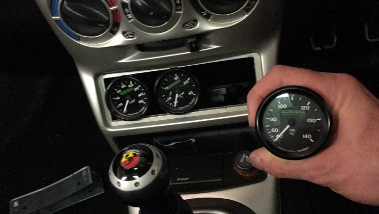

On to the instruments, Racetech gauges which I am sure Guy will approve of, very easy to install as they are mechanical so no wiring, oil and coolant temperature, oil pressure
racetech guages.jpg (117.05 KiB) Viewed 161146 times

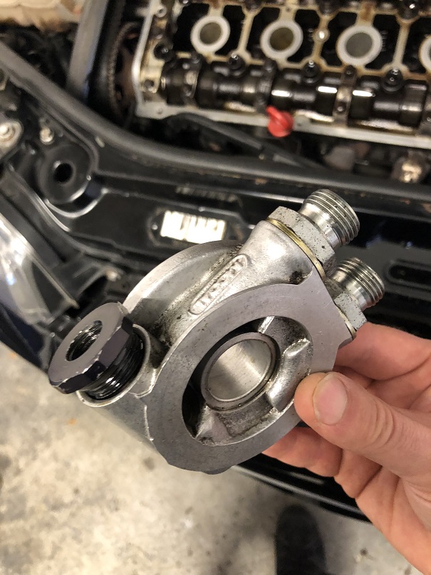

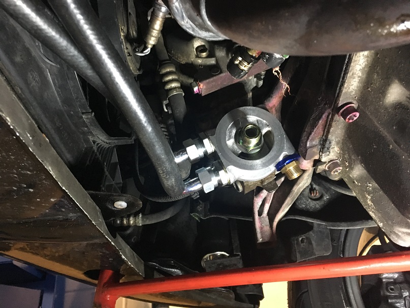

the oil temp I will fit into the mocal sandwich plate, I cleaned it up with some jizer brake cleaner before fitted (after this picture was taken)
mocal sandwich plate.jpg (178.78 KiB) Viewed 161145 times

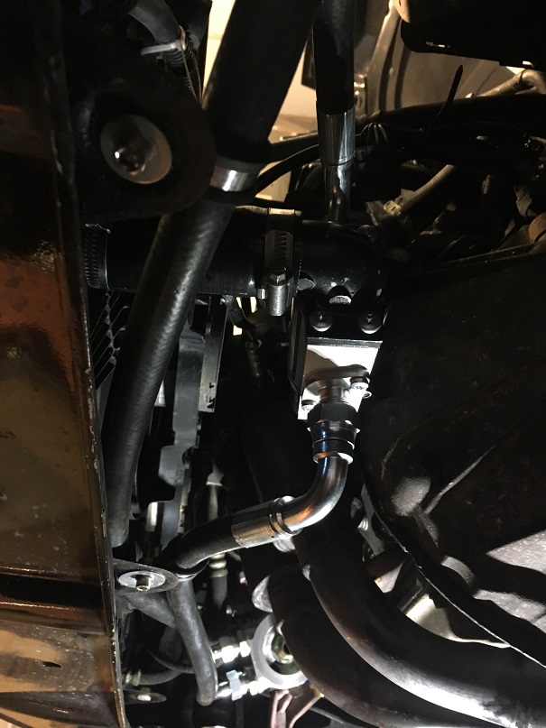

I had a mocal laminova left over from my uno turbo which i didn't end up using so it will be perfect for this punto, it is the smallest size so equivelent to a 10-13row air to air oil cooler, I decided to fit it into the lower radiator hose due to the shape of the hose meaning it was a easy fit, the oil lines I used mocal 1/2" 100r6 hose with 1/2" fittings from Think automotive.
oil filter on.jpg (189.67 KiB) Viewed 161145 times

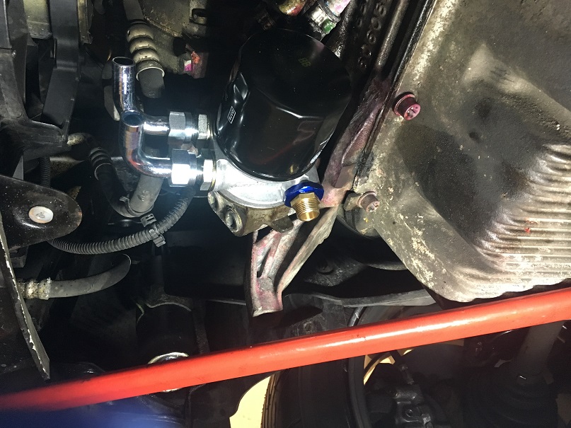

the hgt uses a oil/water heat exchanger which I removed and in its place a mocal sandwich plate with a m20 extension bolt, the original (new) oil filter still fits
sandwich on no filter.jpg (193.39 KiB) Viewed 161145 times
oil lines fitted and secured with rubber lined p clips, the aim is to keep the oil temps below 85-90 degrees.

The only observation I would make is that I would never use push-on rubber hose and clips on oil lines. It's just too risky. I've seen them leak and blow off, same goes for fir-tree push-on hose and swivels.
I've tried all the different methods and the only one I recommend is Mocal 100R6 stainless-braided with crimped-on swivels. Think Automotive make this up at their works. Always fit one straight swivel to any hose (the other end can carry a straight, 45 or 90 deg swivel) and following this rule prevents the hose from coiling up when you fit it.
