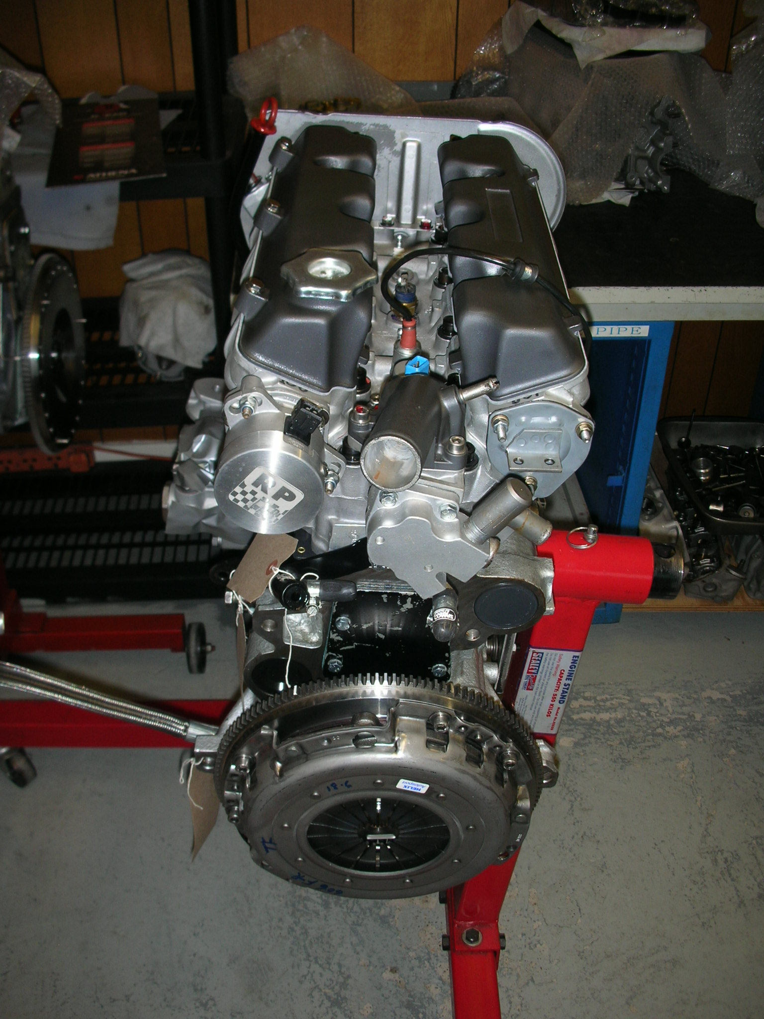

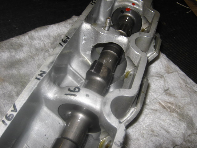

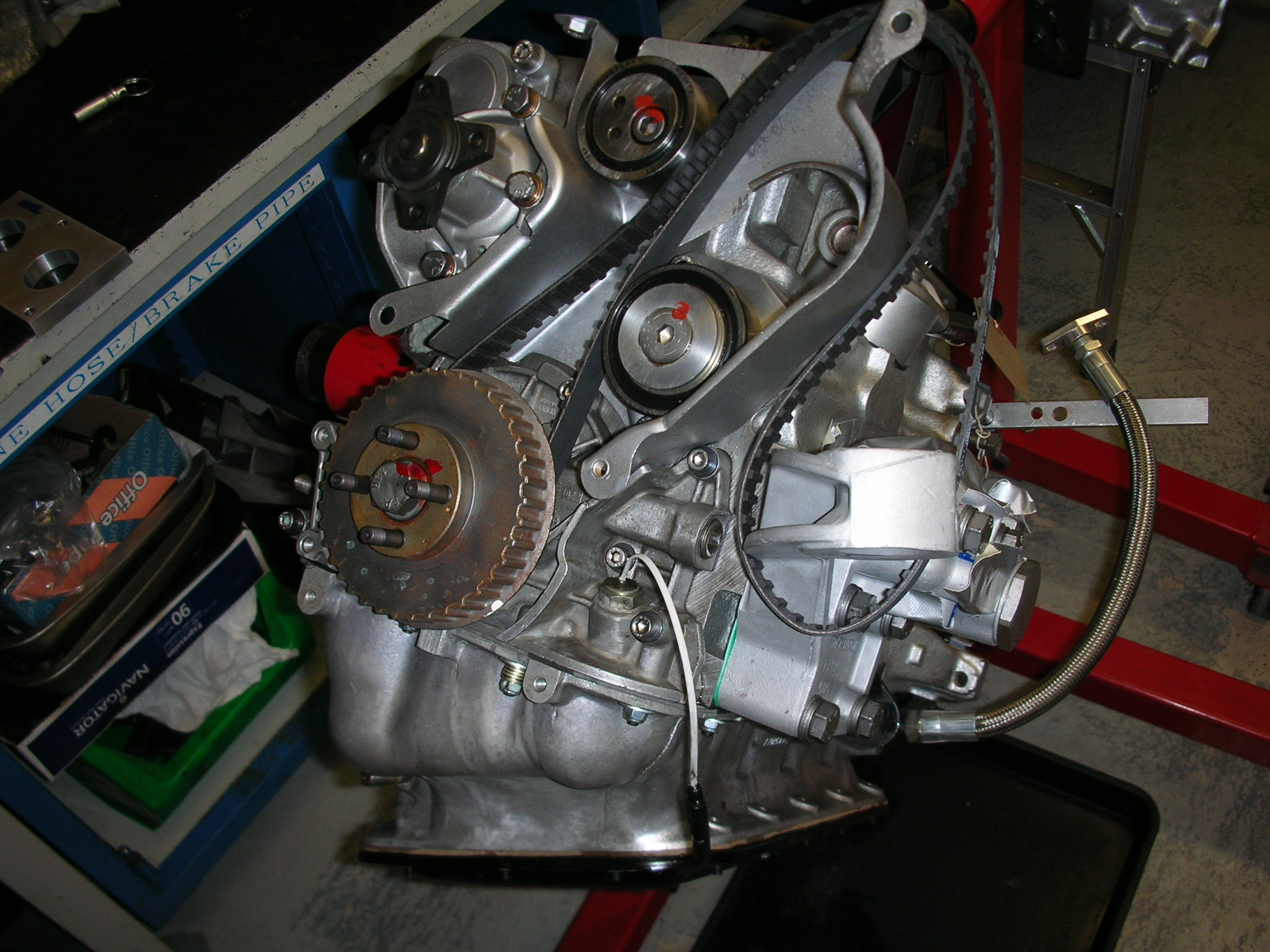

Tom Frames' engine - crankcase this week after complete strip/prep and re-assembly. I had to completely strip the entire fcuking engine.
Next op put the overhauled cylinder head together with a TRUSTWORTHY inlet cam of my own profile by Kent Cams and an OE 8v Integrale ex cam with the cam sensor drive slot in the right place...
I mean, I cannot simply 'bang' the engine together with metal debris everywhere.
I have stripped every part of this engine and inspected and cleaned every single piece. Only if you have done this can you possibly imagine how long that takes for an 8V Integrale and how much space it takes up....
Damn Colombo and Bariani for wasting MY TIME and my client's hard-earned money on this inappropriate-up and trying to kid me that their products were fit for use...
Given that Colombo and Bariani cannot supply 8V Integrale cams to me anymore that I can trust I think I will start making steel billet cams again as I did in the 90s
I hope that respected members of this site will forgive my extreme anger over this.... it may seem to fly in face of my website protocols but I make an exception in this case as the man who pays to run this respected forum...

Tom's cylinder in build today with an OE spec Int 8v ex cam and GC 2B inlet cam..
I could really do without this, at any price, I have much more important things to do.
C&B - thanks (not) for this imposition....
GC engines are built BY ME to last 20 years or more, not ten minutes...
