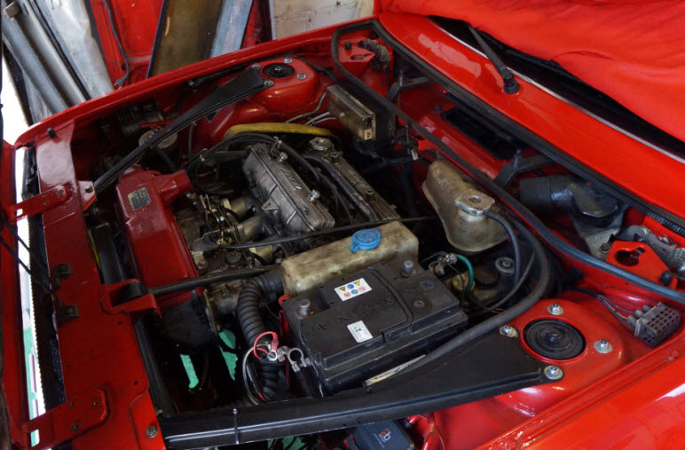

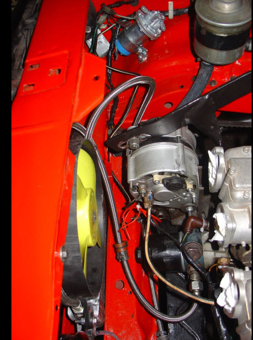

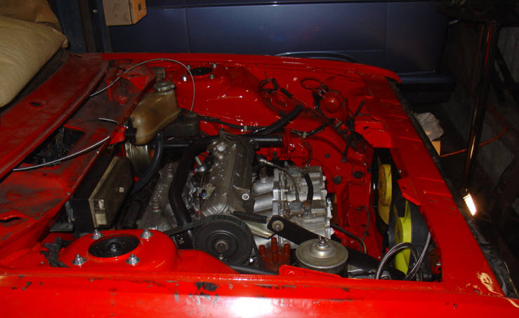

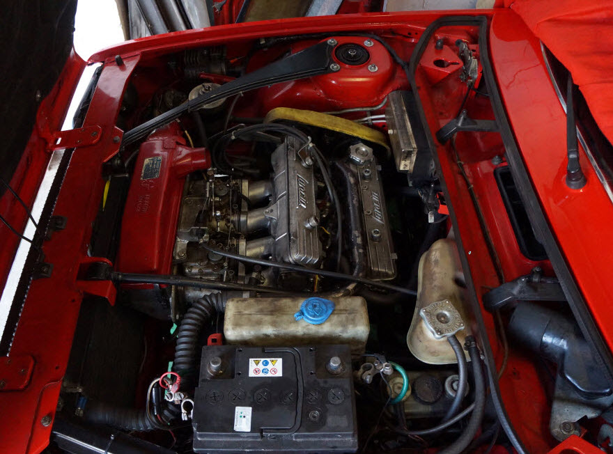

Please find a few pictures attached, 48-47 from restauration , 45-46 most recent condition before head came off. Will take a few better pics mid-July, business & holiday trips coming up.

Does your airbox induct cold air from the front? I can only see an air duct that goes over the cambox...

=>Uno Turbo water cooler with twin viscos set to 75°C plus a manual switch
Have worked-out the Head & Intake Concept for my Streetcar project with moderate 160bhp similar to the Use case F [Camshafts& Valve trains] from your Book built on the previously described Engine block including the Solex carbs.
Please comment and give advice to whether the Concept is making sense and/or changes would make sense;
- Air-intake with plastic funnel into leftside of the Abarth Filter Box to ensure cold air push from front grill
-Solex 45 ADDHE re-jetted with 36 choke and Main 145, 185 Air Corrector, idle jet 55/70, Pump jet 45 and isolator washers (already installed) similar to 2l 8V 140/160bHP Engine concepts
-Fuel pump either to be adjusted to 3,5 PSI or to be replaced with pump which can do the pressure
-VX Head to undergo refacing and to be flowed on flow bench plus precision valve seat grinding & blue printing of std VX valves as required with local Engine Shop
-Inlet cam GC Std. II Road Cam AS1600(F)
-Outlet cam GC Std. IIA Road Cam AS1600(F)
-Spesso Cylinder heat gasket improved
-check the Carburettors with Oldtimer Engine Specialist in Zürich who will be adjusting them after
This is built on the Block with raised compression ratio 10:1 with forged conrods and a 4-2-1 exhaust manifold with slightly different silencer, hope I didn’t forget anything.
Thanks for your advice,
Regards
André
Sorry for the delayed answer, had paused my Project due to other priorities although few things have been done;
=>]Engine block was out and disassembled for cleaning, all oil-water emulsion has been cleaned from bearing, pistons, etc. Bearings have been checked for scratch marks and scorring
=>Oil cooler and thermostat has been disassembled and cleaned, flushed, it is an AK6 High Perfomance Oil cooler with 8 rows, thermostat states 85°C
=>Fly wheel thread cleaned and re-threaded
=>dia 36-inlet ported VX Cylinder Head cleaned and valves taken out, water channels inside have been flow optimised and deburred, porting done a number of Years back was checked and slightly optimised
Regards
André
