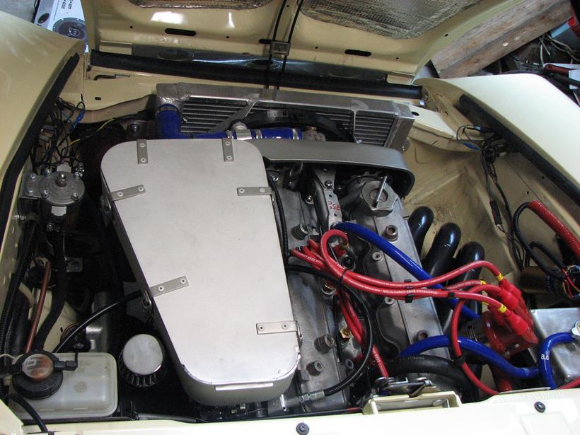

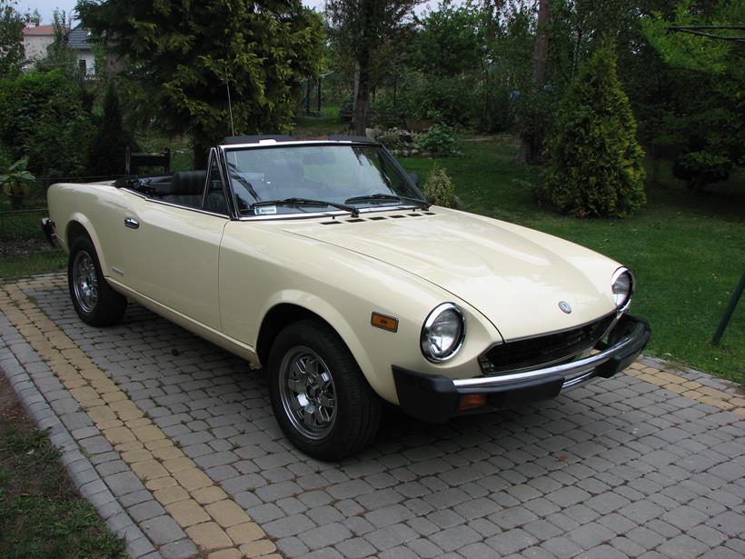

Summer is coming to an end.
My vehicle is currently registered.
A few new photos below.
IMG_0001 (Copy).JPG (109.83 KiB) Viewed 116308 times
IMG_0002 (Copy).JPG (95.85 KiB) Viewed 116308 times
IMG_0009 (Copy).JPG (91.13 KiB) Viewed 116308 times
IMG_0013 (Copy).JPG (93.19 KiB) Viewed 116308 times
IMG_0070 (Copy) (Copy).JPG (68.33 KiB) Viewed 116308 times
IMG_0071 (Copy) (Copy).JPG (90 KiB) Viewed 116308 times
Re: 1983 Pininfarina Europa Spider
Posted: September 26th, 2016, 6:40 pm
by PumaPhil
Looking pristine Marek, a great job. You just need to find a few nice days to drive it before winter arrives.
Great looking seats too.
Posted: September 26th, 2016, 10:13 pm
by Spider 1969
Well done Marek!
What's the gauge under the left side of the dashboard for?
If I see it correctly you have a filter on the crank case breather located next to your air box. I think it will foul your pristine engine bay with greasy droplets so I would advise to route it to a catch tank or to the air box.
Enjoy until winter,

by Marek
Thank you all for your suggestions and hints.
There is still a lot to be done but before the next season might be able to prepare the vehicle.
Charles, forgive me please, but did not have time to answer before.
Ultimately, I'm going to install catch tank.
