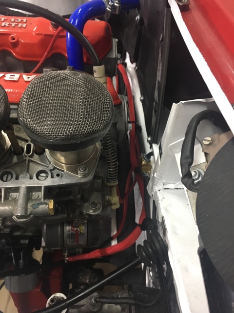

I know it's not the GC engine ...
...but just would like to remark that the gauze traps on the rampipes will lose you measurable power MM..

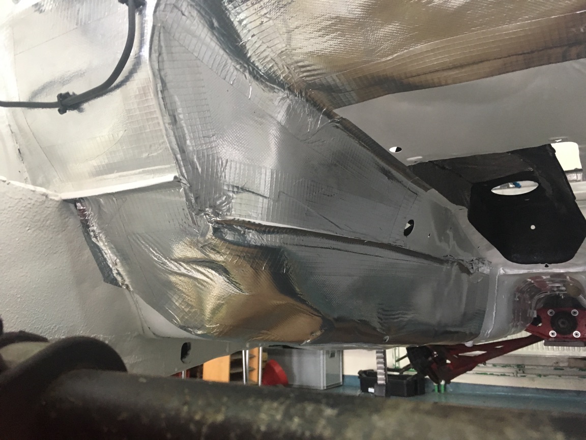

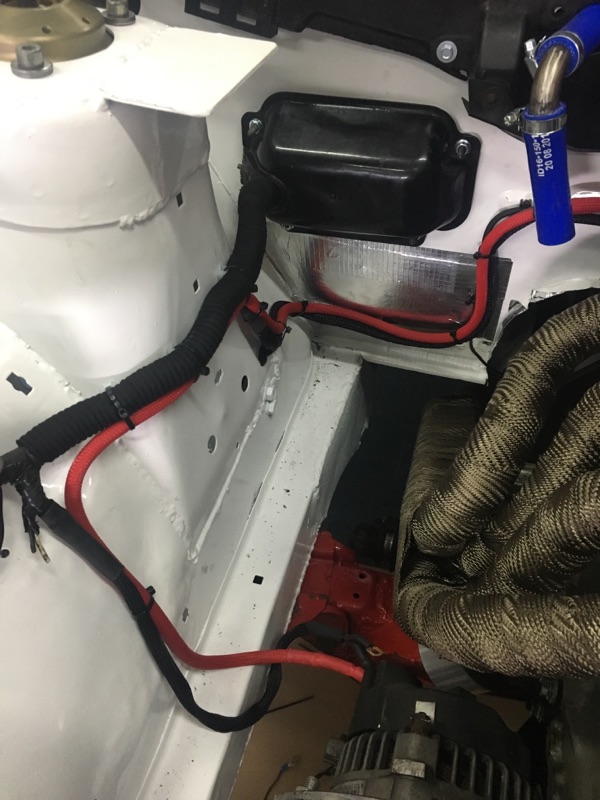

Heat shielding of the tunnel
... and quality heater hoses

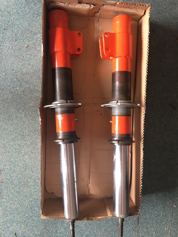

Rebuild and adjusted for bumpy tarmac surface original Bilstein dampers

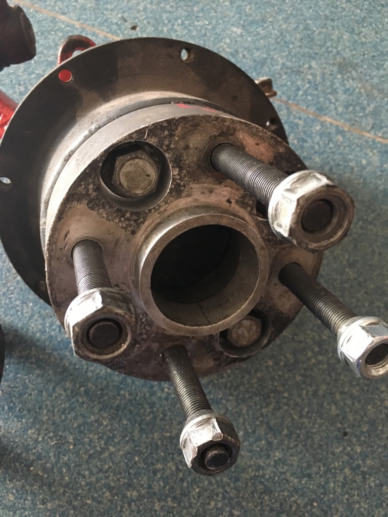

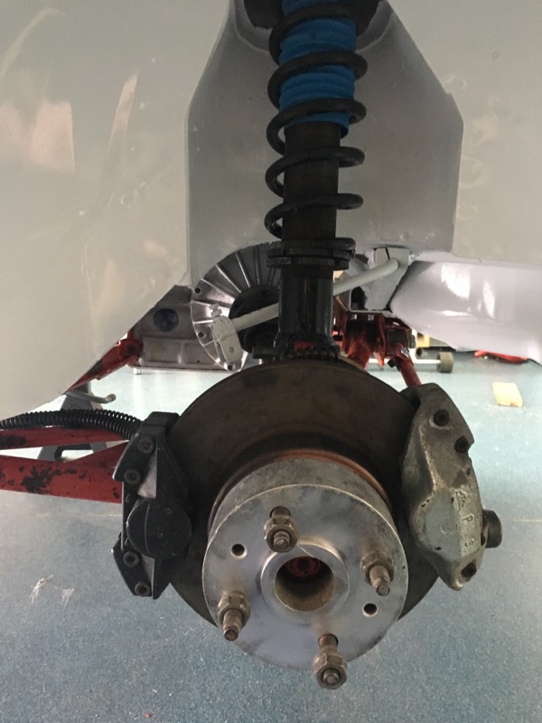

Rear brakes (distance plate)
Front distance plate)

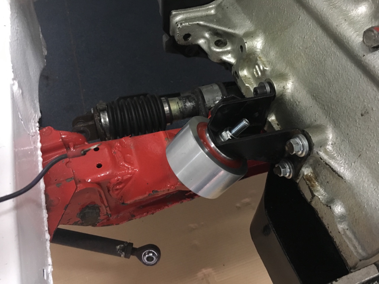

New strengthened engine supports ( old were too soft and got broken under heat stress which caused the power train to wobble causing several problems including damage to heater hose rupture on a powers stage/

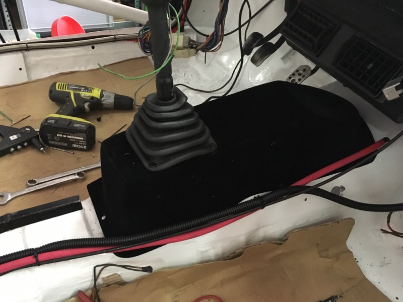

Refinished "coffin"

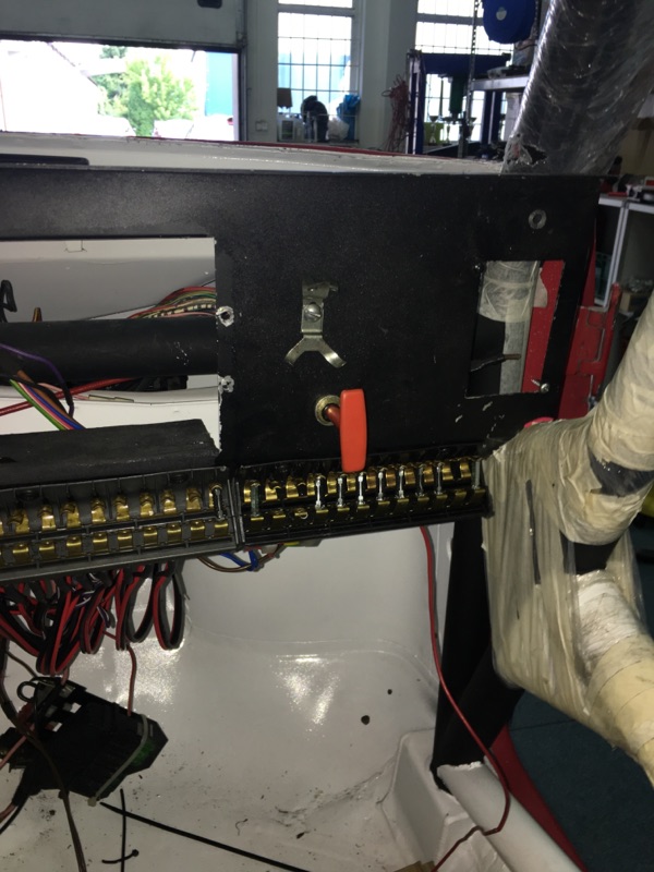

New kill switch for the co-driver and additional open fuses

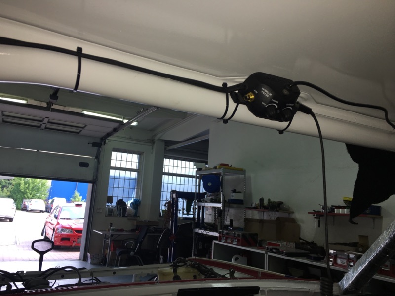

New intercom location

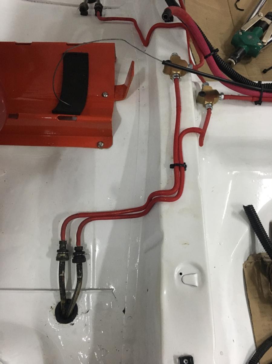

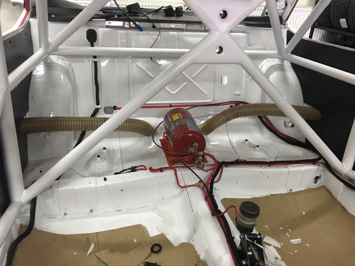

Anti torpedo on the extinguisher system and brake cables layout
Refinished "coffin"

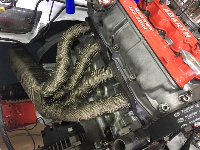

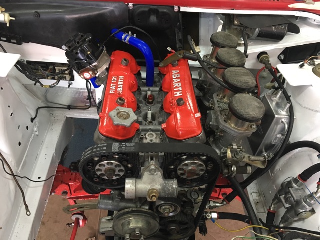

Engine in place !! Wiring in place Heat shield in place Exhaust installed Looks like the next rally of our Historic Poland Championship series (Lower Silesia : Sept 7-9. 2017) is on ! Rgds
