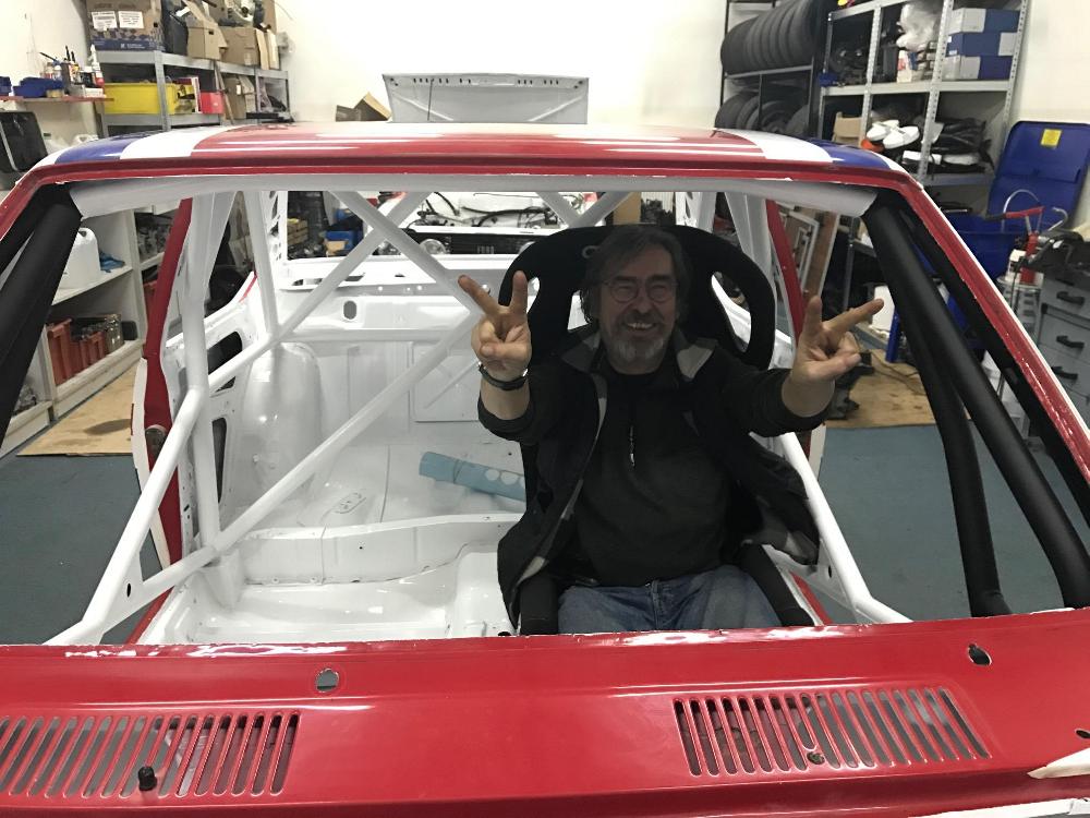

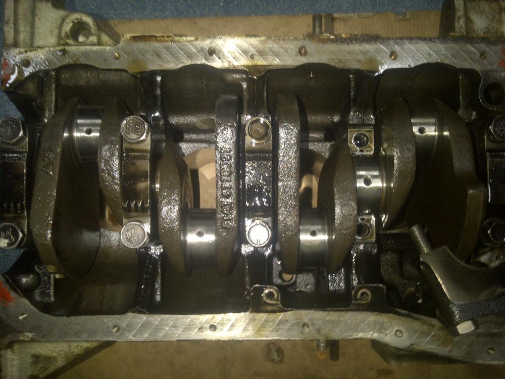

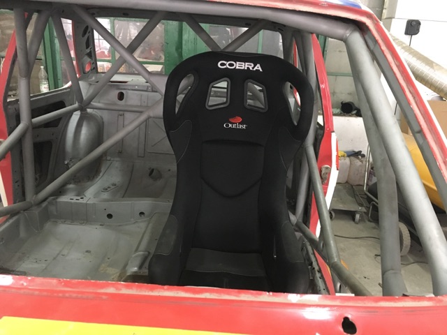

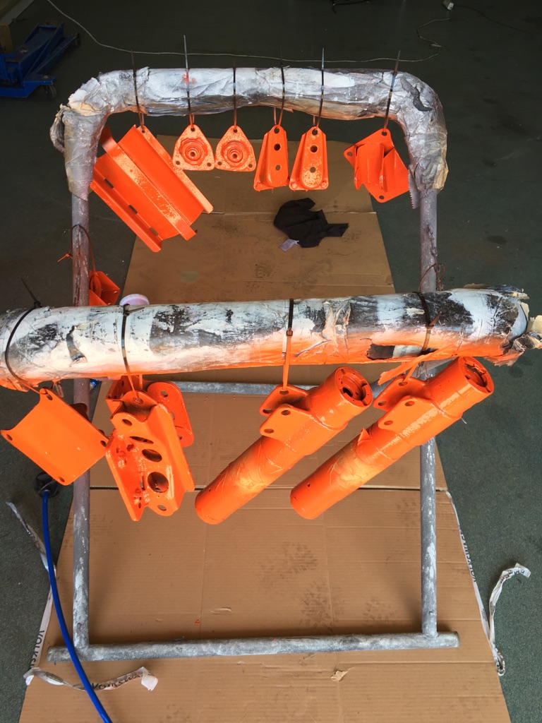

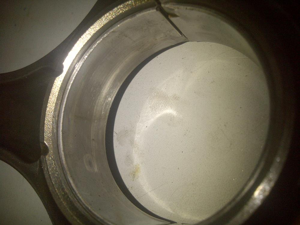

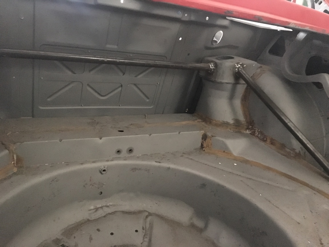

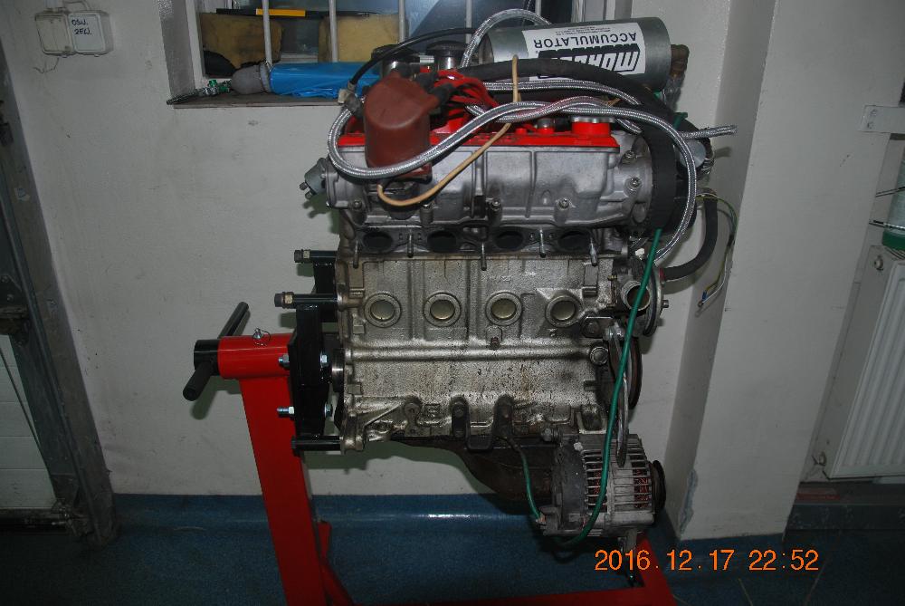

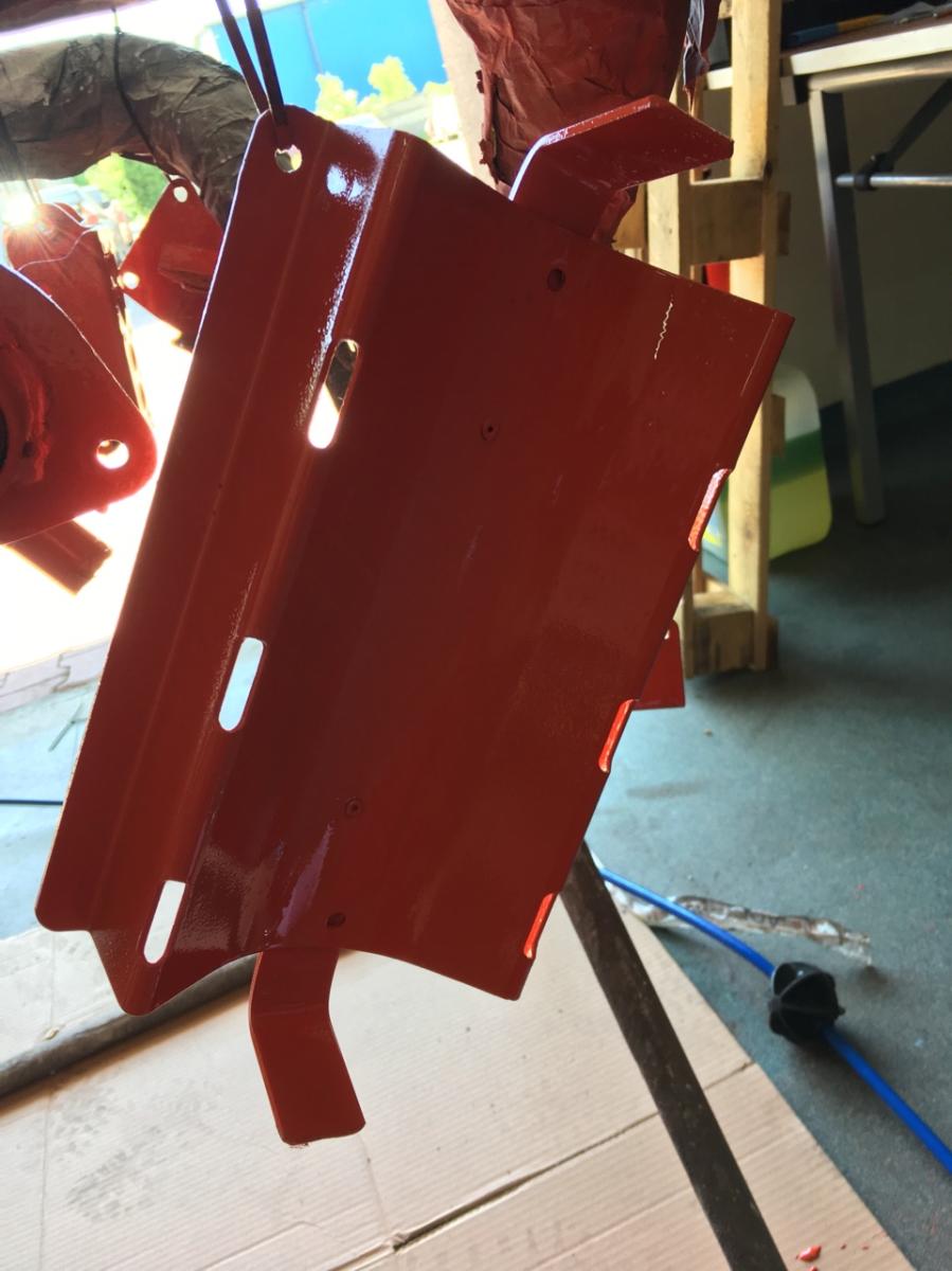

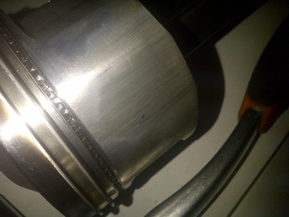

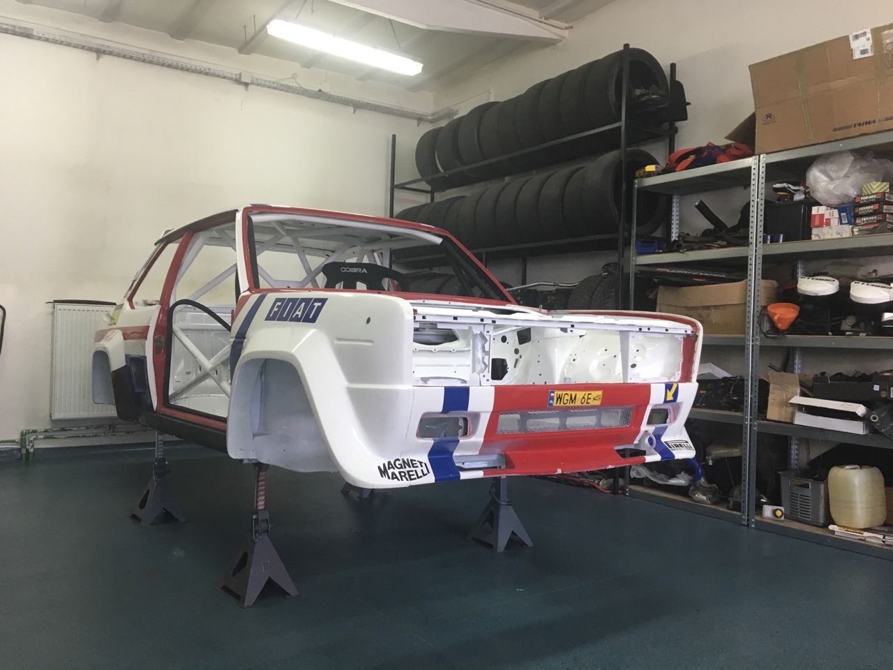

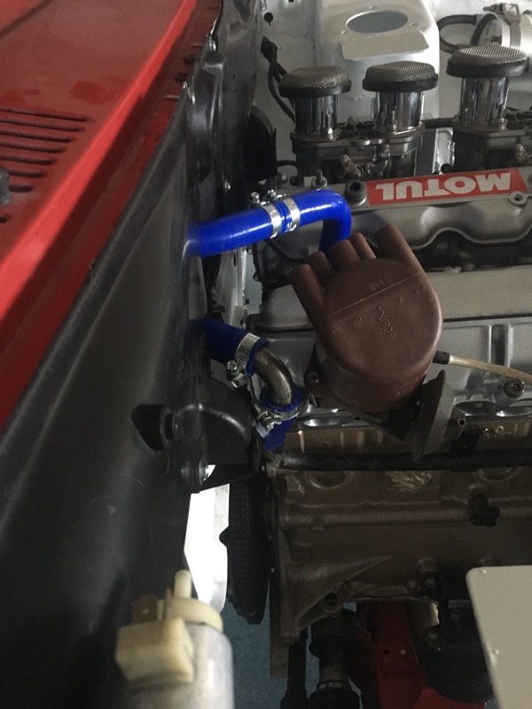

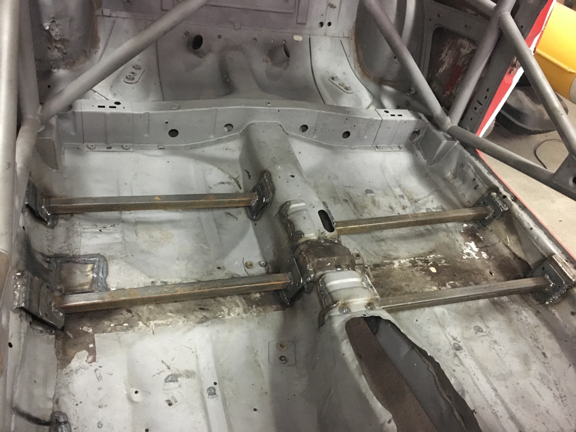

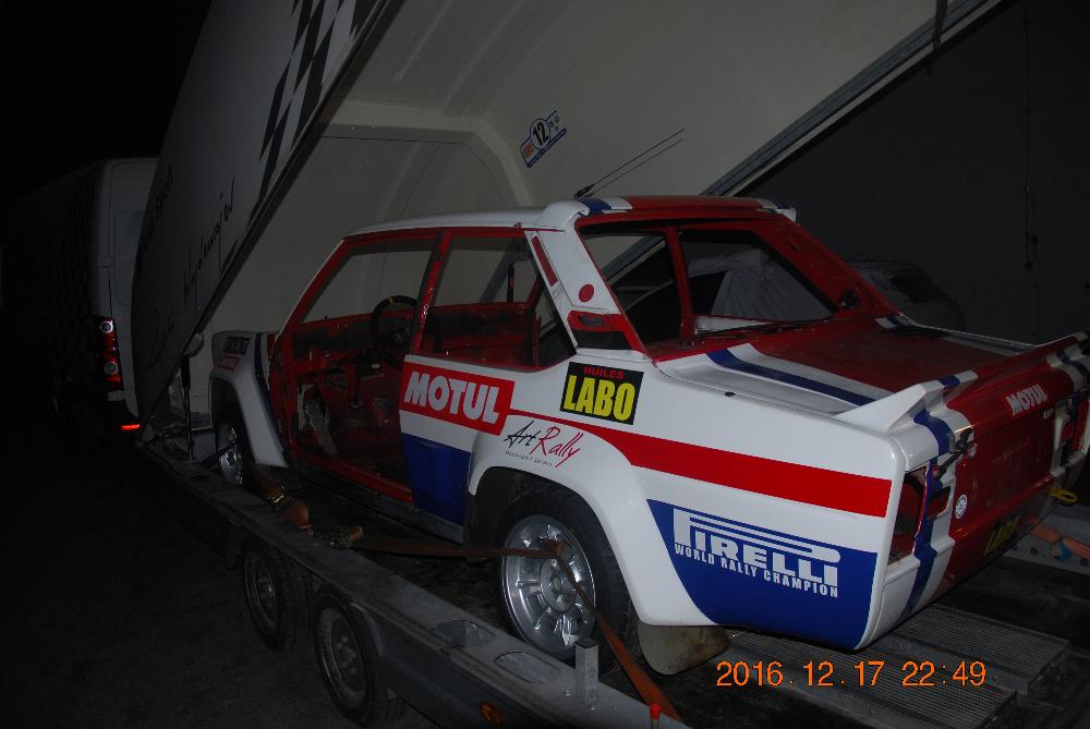

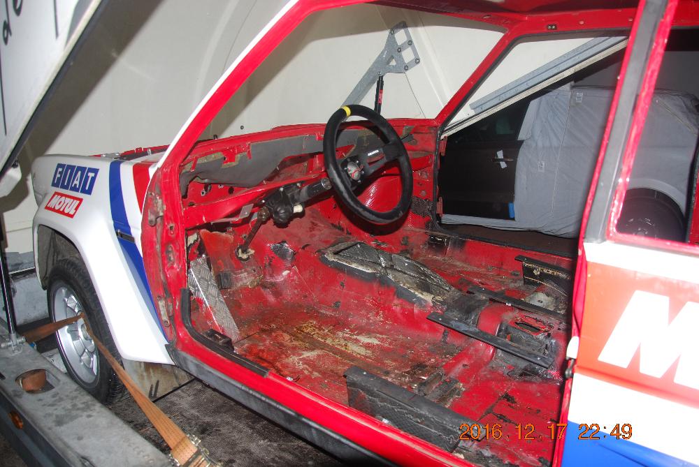

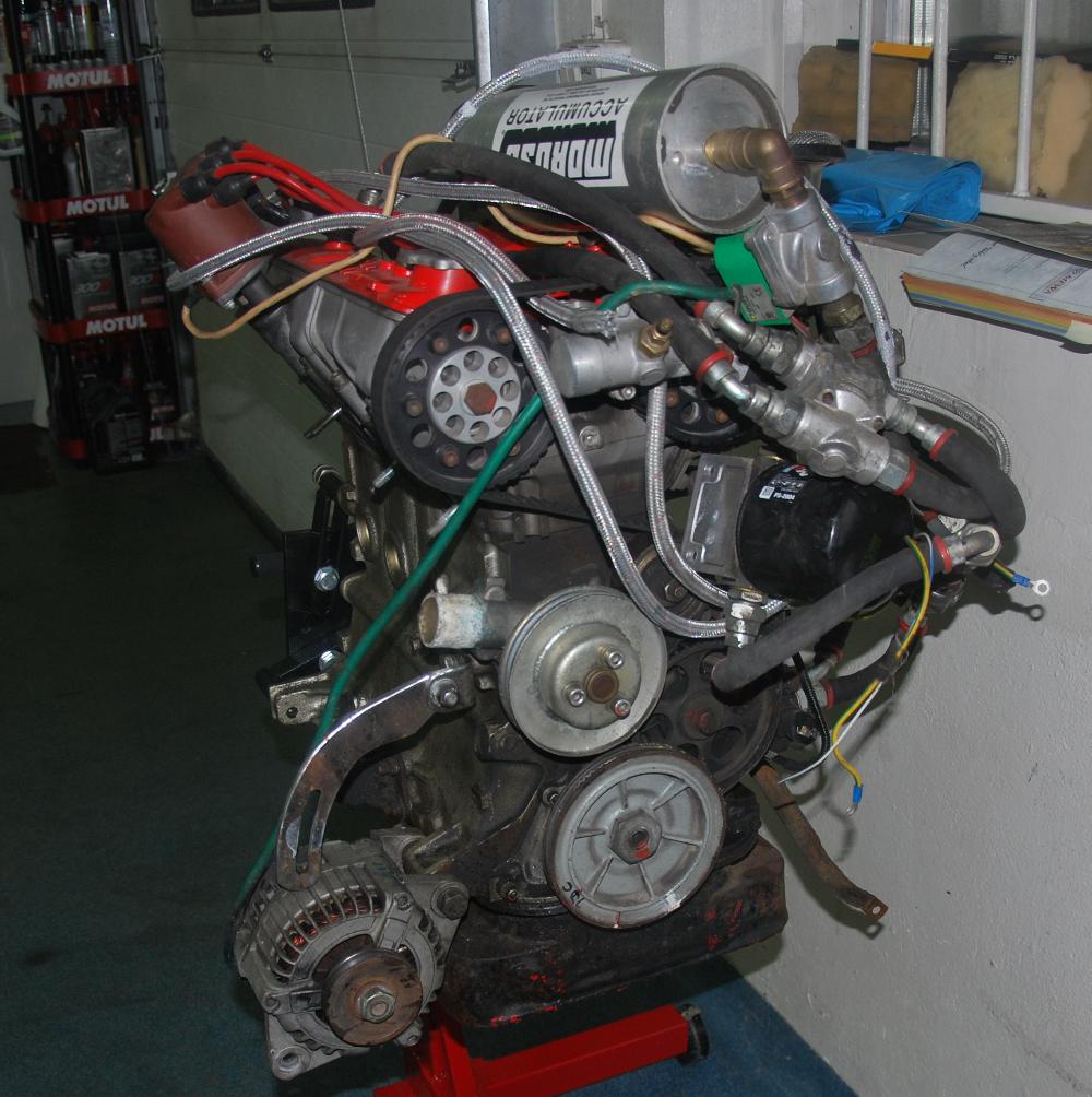

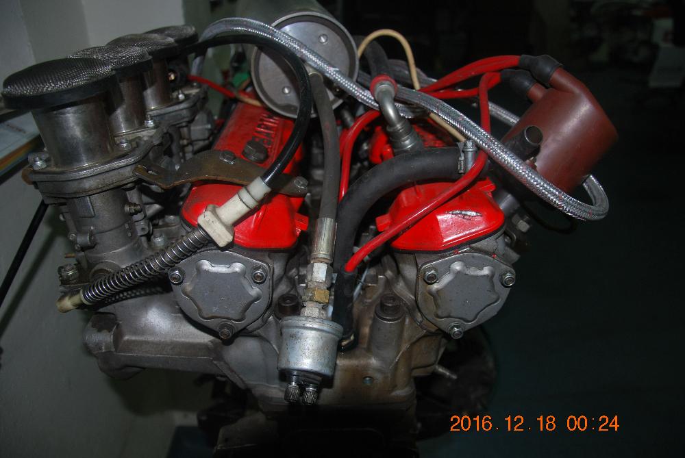

This thread is hereby reopened !

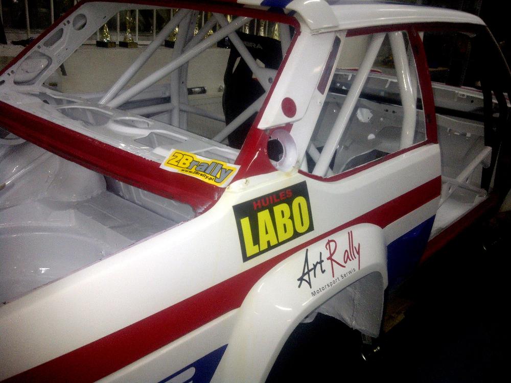

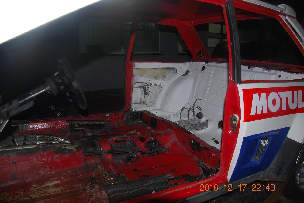

As the car has been rallying for all these years without any engine inspection or body corrections and following Guy;s advise the car has been temporarily retired for extensive inspection:
Body : Inspection of the structure, installation of additional strengthening structures, minor rust elimination, removal of all "civilian" anti corrosion protection , installation of a stronger safety cage

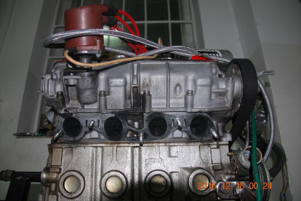

Engine : Complete disassembly and inspection , overhaul exchange of parts and components as required

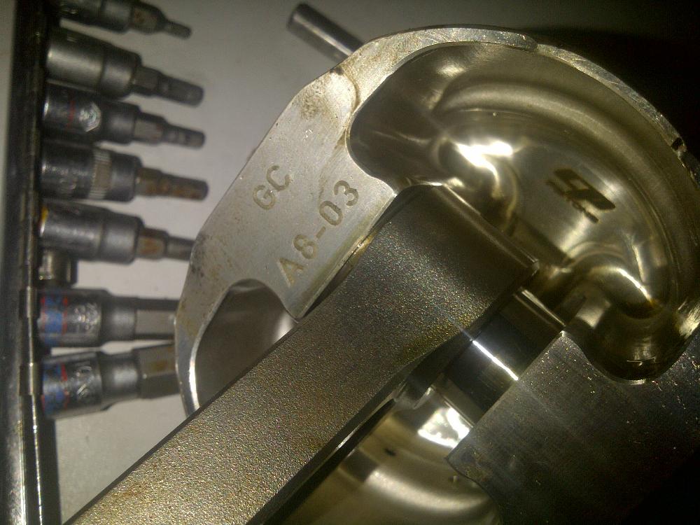

Here are some pictures to show history and progress :
PICTURES SPEAK FOR THEMSELVES THE ENGINE AFTER CA. 10.000 RALLY KILOMETERS IS IN PRISTINE CONDITION.
A BIT OF POLISHING AND CLEANING , SOME NORMAL PARTS CHANGE AND IT WILL BE READY FOR THE NEXT 10.000 RALLY KM !!!
THANKS GUY !!!!
PHENOMENAL ENGINE BUILDING !!!
VERY HAPPY RACER
MIRO
THANKS GUY !!!!
VERY HAPPY RACER
MIRO

One more picture update ...
Note: don't be fooled : this is not a GCRE engine.
This is a 1.8 build for my 124 Abarth a project waiting in line for finishing the 131 Abarth first.
( see viewtopic.php?f=5&t=3278&start=165)
It has been put into the 131 just to fit all the ancillaries ...
The GCRE is waiting for springs , rings and stuff before being reassembled.
The timeline says about a month from completing the 131 overhaul. Seems like a century ..

Re: My 131 abarth (never ending) story 2007-2014-2017 season updates
Now that is a major overhaul! Well done, I can imagine indeed it seems like a century for your engine to return. Keep it up.
