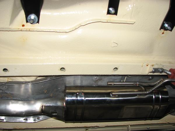

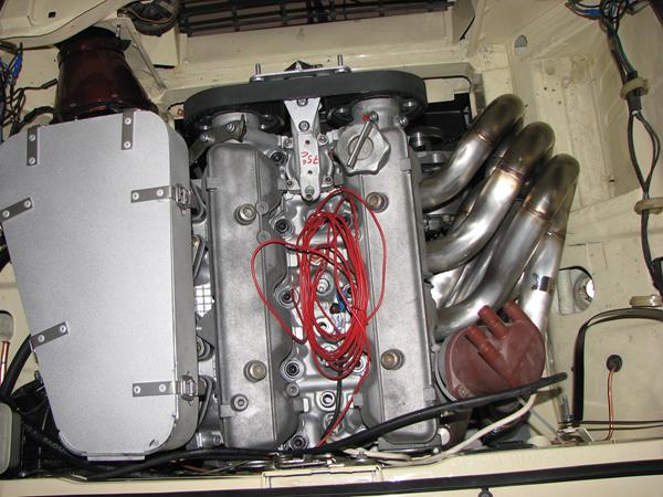

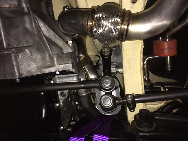

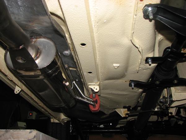

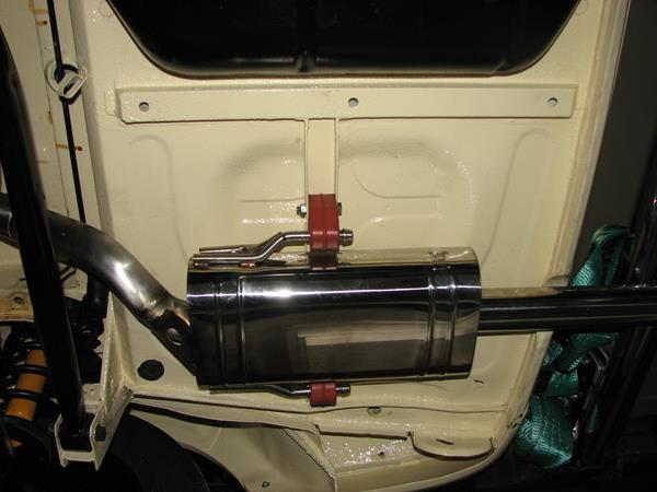

Company Mg Motorsport made a complete exhaust system. I am glad that, and
they just took care of the construction of the exhaust system.
IMG_3345 (Copy).JPG (63.28 KiB) Viewed 107568 times

GC_120
Posts: 160
Re: 1983 Pininfarina Europa Spider
Wow, beautiful exhaust. That's a tight fit! Is the header 4-1 or 4-2-1?

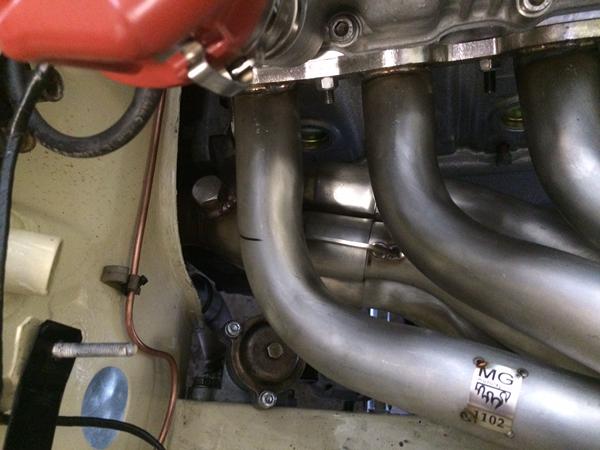

Thank you very much.
Very little space. It is 4-1.
IMG_3772 (Copy).JPG (42.92 KiB) Viewed 107460 times
IMG_3766 (Copy).JPG (38.44 KiB) Viewed 107460 times
Well done!
This is a careful & thoughtful job by your supplier Marek, done as close as possible to GC design regime. Not easy no. I suggested 4-1. A 4-2-1 manifold to a modern design (ie: optimal, to my spec) is almost impossible in the 124 ...
I like the care they have taken with the flexible joint and the nice suspension of the rear silencer. I can see they have done some nice cosmetic work too, polishing to make it look nice.
The pipe bends look good too, I would say they are all to GC spec ie: bend chord radius = 2 x pipe inner diameter.
A manifold like this generates a huge amount of heat in the engine bay, it can destroy your distributor! I would strongly advise you examine some thermal coating like the Zircotec we use here.
Tuning the 124 Coupe and Spider explores the LIMITS of what is possible in the restricted architecture of the engine bay. No room for anything!
