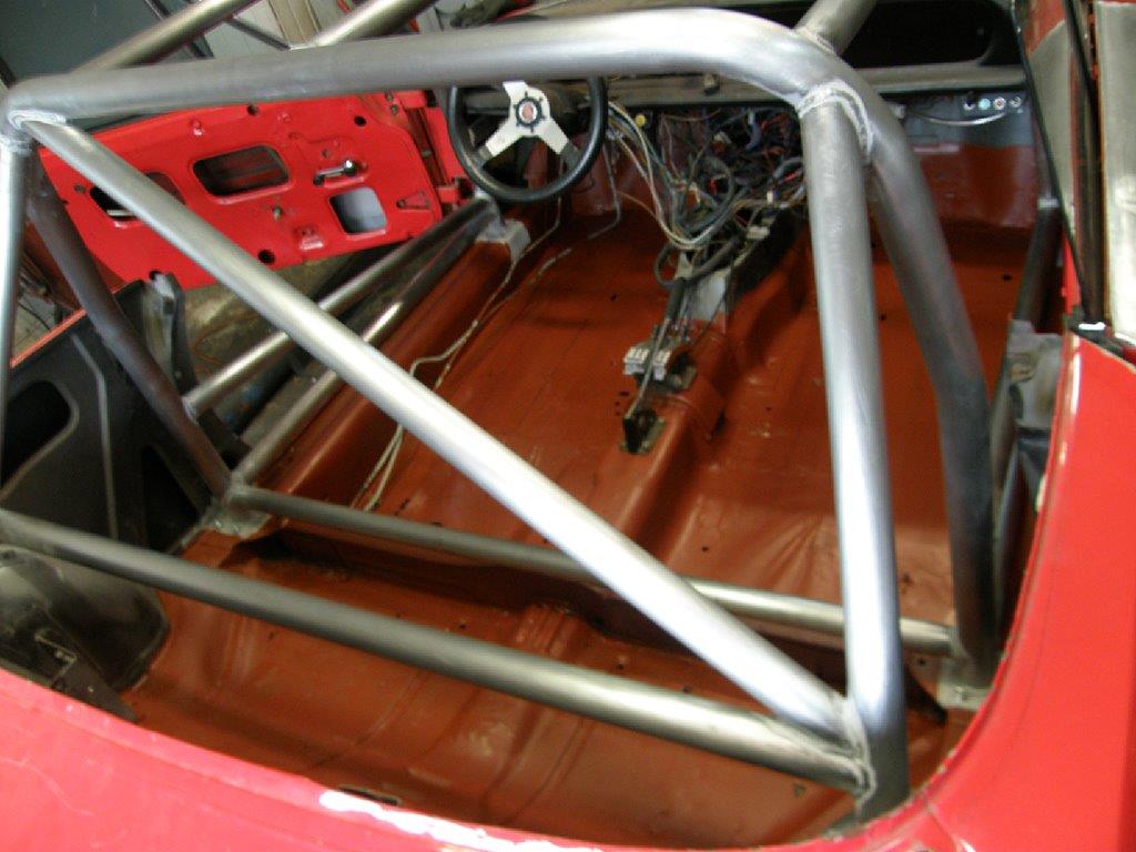

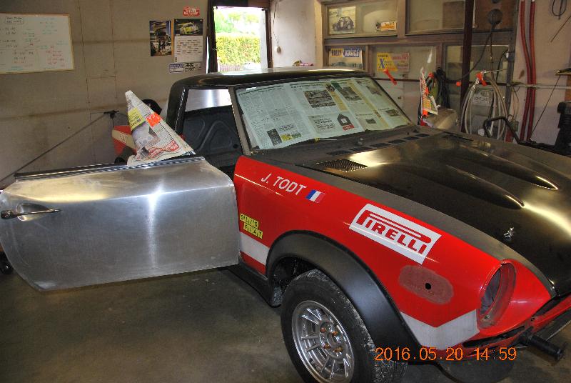

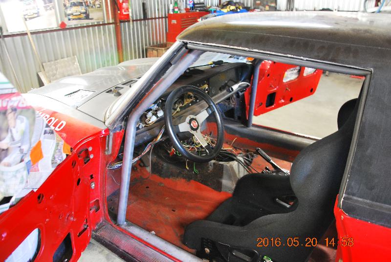

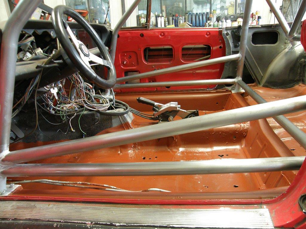

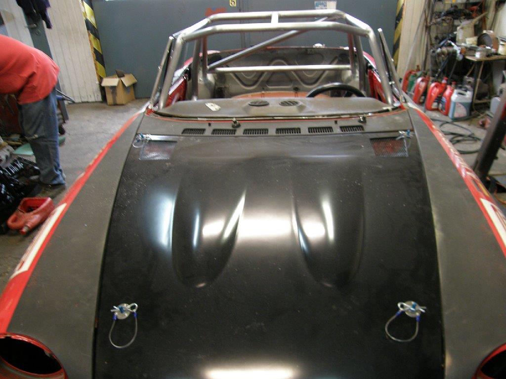

Small picture update :
The cage is already welded in in acordance with Attachment K.
Few more elements in the process :
- Gear Reduction Starter for the 124 Spider from Allisson Automotive - in shipping.
- Abarth style bonnet clips - in shipping
The pictures you see below were taken before the safety cage was actually constructed and welded in. After a dry fitting , I decided to move front bar supports its elements slightly forwards ( by 2 cm ) and add a diagonal bar on the floor behind the seats. By now the cage is finished and looks really great ( no pictures yet)
Now we will install the full Abarth suspension and brakes and send it to the paint shop.
Once it comes back the work will concentrate on installing all interior parts ( dash, fire extinguisher system, protective foam and hard FIA foam bars on the cage etc and design the tank. We will actually weld a tank shape from a thin steel sheets and pass it onto the builder. Before this will take place we need all the tank parts ( plate from ATL , anti explosion material. etc.
Hopefully, I will drive this car to a rally still this season ...

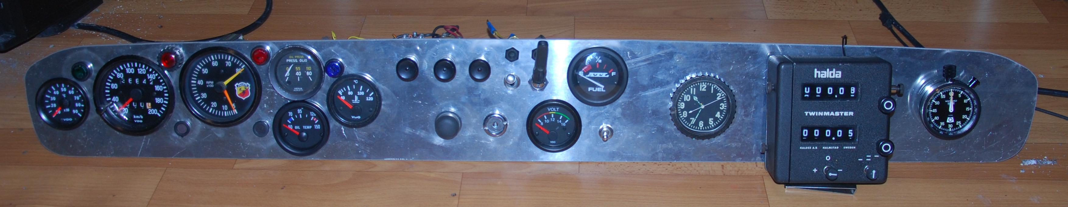

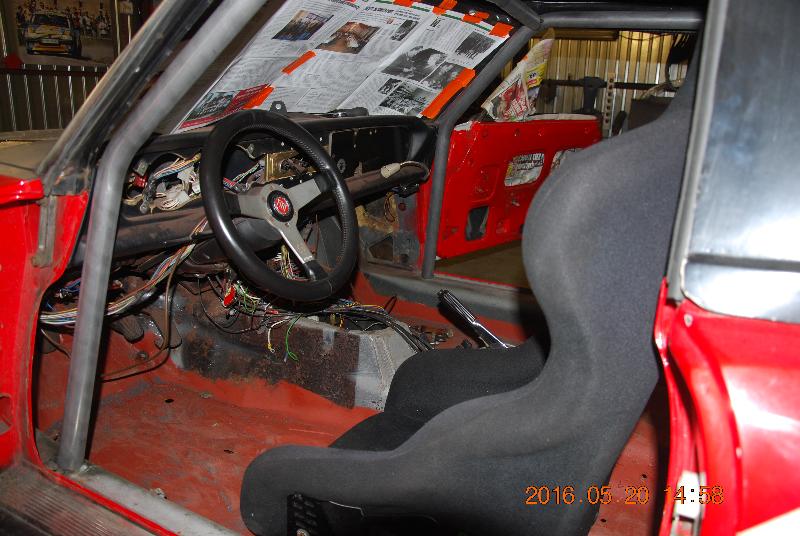

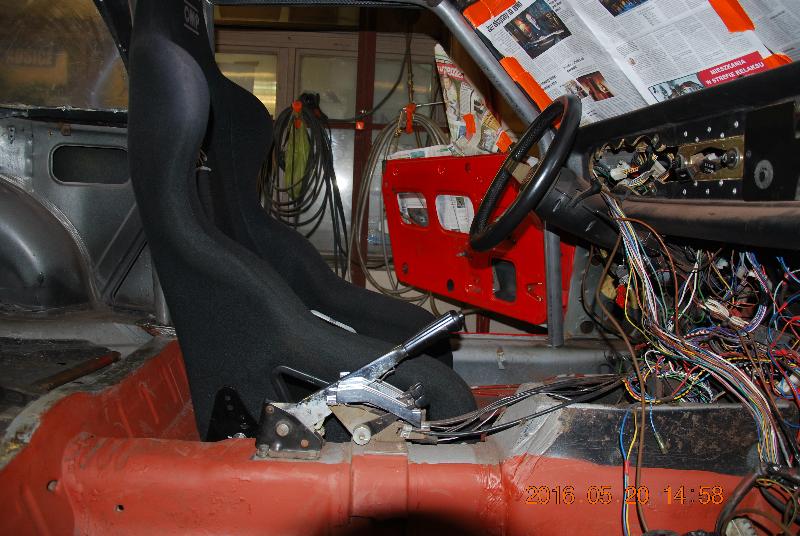

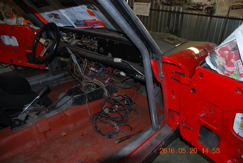

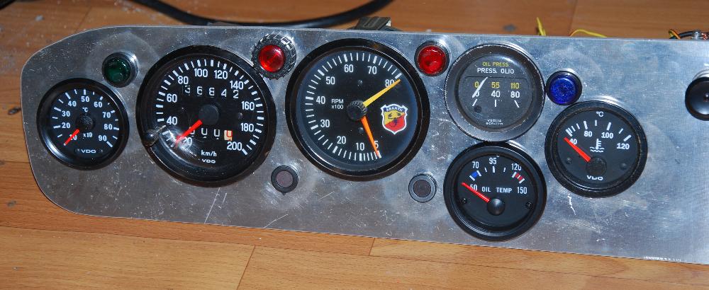

WELL,
yet another pictorial update :
The chassis is being prepared for painting.
Before this is done we must still design and install fly-off habndbrake ... and fit the seats.
The seats selected ( based on my excellent experience with Cobra ) are Sebring for the are driver and Suzuka for the co-pilot : And finally the dash plate was finally water cut and was dry fit today. I think it looks OK.
Note: some of the gauges were fitted just to verify whole sizes and will be replaced with more vintage - if we can find them. If you have some old gauges spare ( oil temp / water temp / volt / i will be happy to trade for many spares I have .

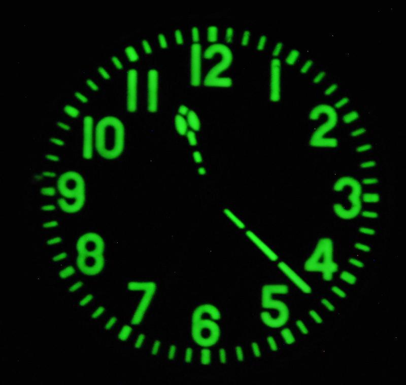

A small centrally located underpanel will have the emergency switch ( 4 way fpasher , cut off switch and extinguisher system handle. There will be a long fuse plate under left center of the Halda and map lamp/Halda lighting switch on a small panel under the Heuer stop watch. The Heuer and the clock will have small red pilot lights for night reading . The dash will be satin black.
Incidentally the Russian tank clock has a phosphorous digits and hands and does indeed light up very nicely in total darkness - even w/o additional lighting.
More to come
RGS

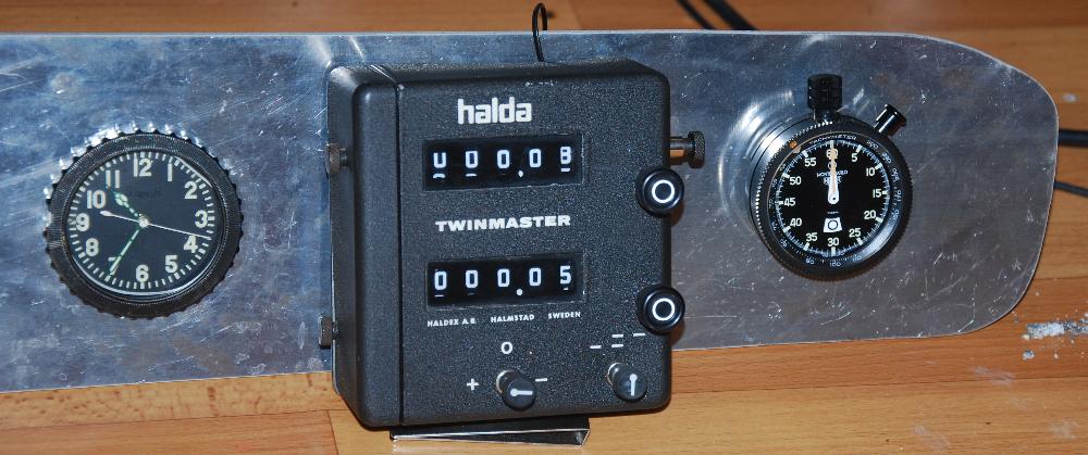

if any of these are use MM you are welcome to them,
as to whether they work or not no idea, sorry! Niels van Buuren is getting all his 124 CSA ones checked and accurately calibrated with new senders where required (esp oil press & engine temp). New senders I guess it has to be Csaba Vandor at Autoricambi in the USA.
If you run an old oil pressure gauge and sender it will read garbage! I mention this for the general readership!

Thanks GC
I could actually use these small ones . The large ones I have plenty of.
I would like to stress how important is your remark about old gauges and old senders.
It is like having false sense of security. Whenever I use old gauges I use new senders ( non PRC made) and the gauges are professionally checked by a Polish Office of Measures and Weights lab and if necessary re-calibrated at Warsaw Polytechnic University lab.
These gauges are there not for show but to warn you of any developing engine problem. They have to be really reliable . In aviation they are often redundant , to make sure that of one brakes the other works amd gives you early warning.
Incidentally when you put such a beast together you'd better protect your investment ...
Mine is in production ...

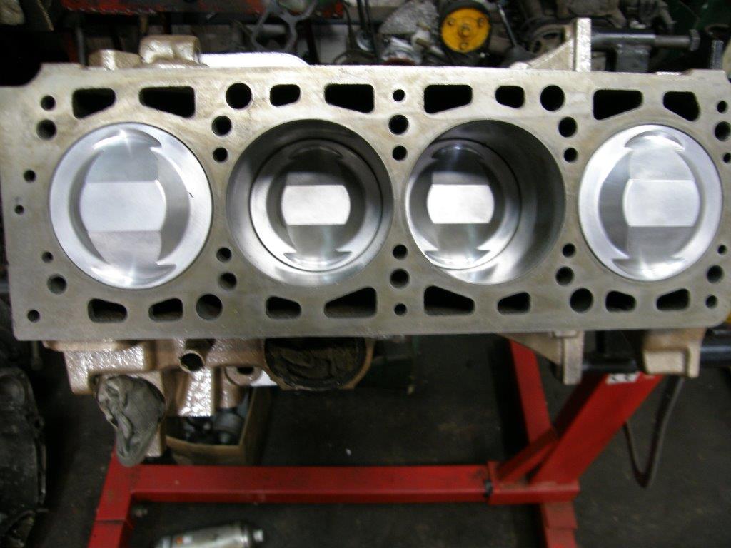

Where are you bought this pistons Miro ? Are they are from Supertech ?

Dear Guy,
I do not know if my understanding is accurate , but I suspect I have an idea what you are referring to.
Pistons and their design.
I am by no means a pistons design expert, but if GC says so - it is so.
I also have no idea where are these pistons from. Mechanic sent a picture and I posted it.
I gather from GC reaction these look like GC designed pistons and these are copies of his design.
I know a lot of cars but I am not technical enough to tell one piston form another , and though I have seen such piston before here at the forum I do not know the intricacies of what goes into the piston design : is it the dome shape or material or anything else.
You, Guy, as the most effected ( and from whom the design was stolen ) know immediately when you see one.
I need to be instructed !
I assure you these pistons were bought legally and from a legally operating entity - if I am not mistaken from the US. But I do not even recognize any of the company names, which you mentioned (except for Cat, whose cams I had on the shelf )
I will get all this information who sold it to us and will transfer this info to you, Guy , off line.
You know, Guy, what I think of counterfeits.
If required I will try to obtain paperwork documenting the transaction for potential legal action against the supplier.

Peter , you wrote:
[quote=" These type of seats that you choose as a driver seat are very good in my opinion, but in historical car I think that seats without "ears" are better choice.[/quote]
Tell it to the crew after a major crash on a stage.
This is not a display replica but a fully rally worthy rally car.
I will be driving it and whereas I will not easily compromise on historical technical elements or non-safety related visual stuff , but when it comes to safety: no compromise whatsoever.
The question is simple really - if you have crash, which seat you would rather be in ...
