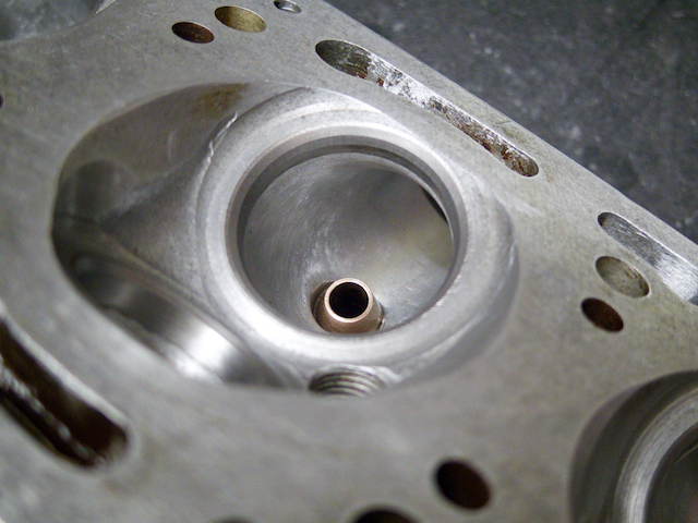

Chamfering the guide bores
Deburring and cleaning up the guide bores with 400 grade

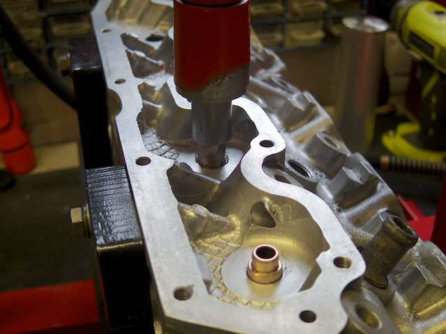

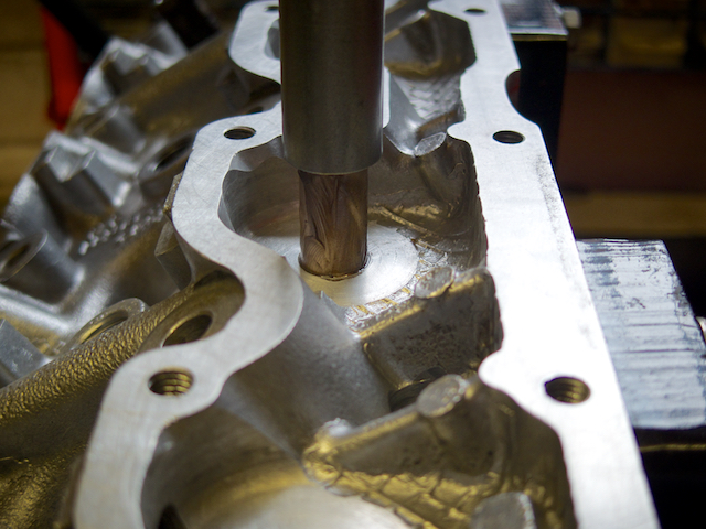

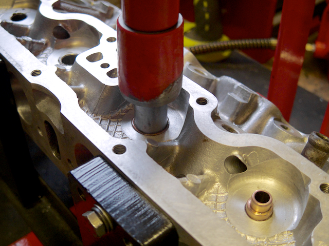

Pressing in the guides after lubing with 'copaslip'
Very satisfying to 'feel' the guide gradually squeeze in as the press pump handle is worked!

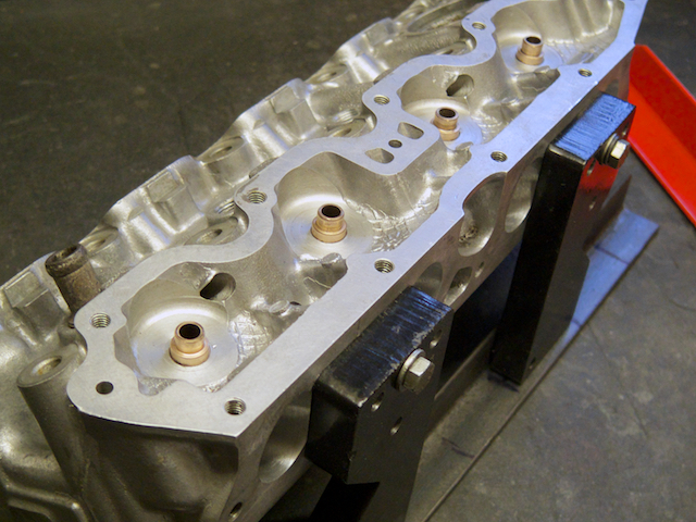

Fully home with insertion tool bottommed out setting the depth. I'm glad I bothered to spend the extra time on the tool, rather than having to constantly measure.
Finally, all the guides in.

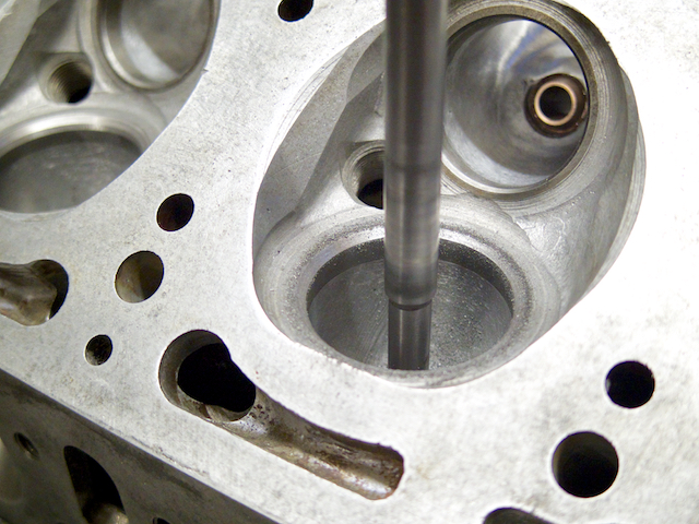

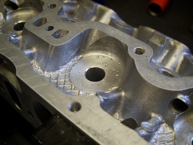

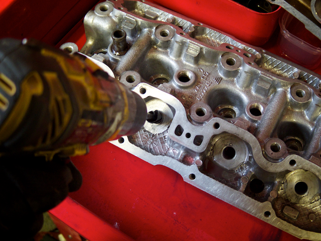

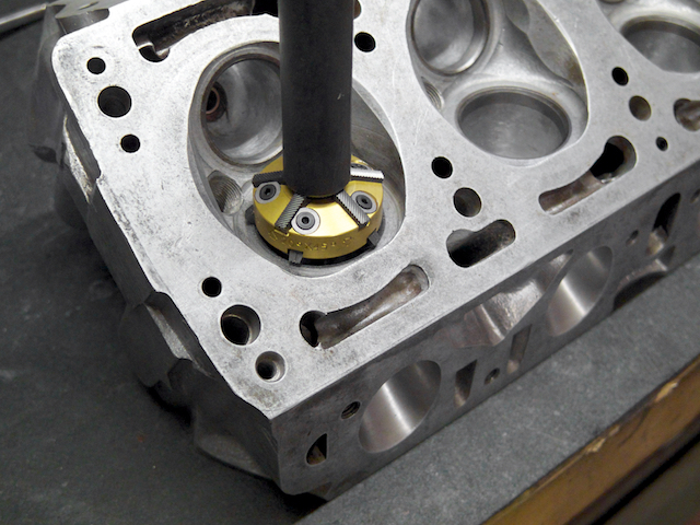

Using then Neway cutters to start recutting the seats. 20 deg top cut, 45 deg seat, and 70 deg throat.
Taking the 45 seat out to valve full valve diameter.
I need spin up the valve grinder tomorrow to clean up the valve faces, and flex hone the guides to fit the valves. Then I think I will check the stem heights to see how consistent the seat depths are.

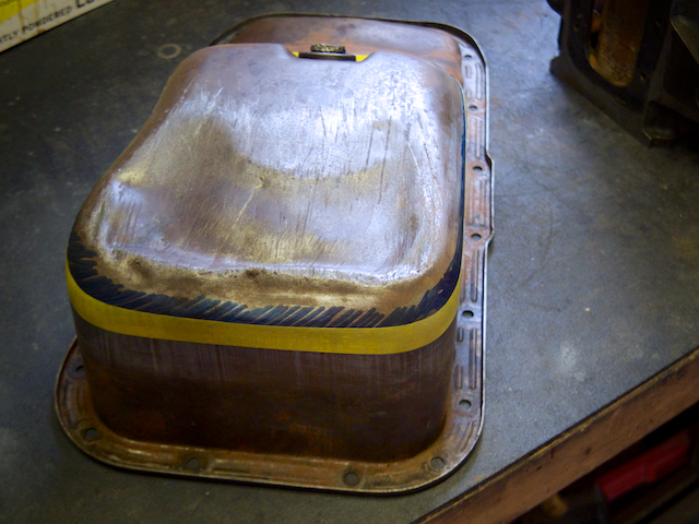

The old battered sump pan

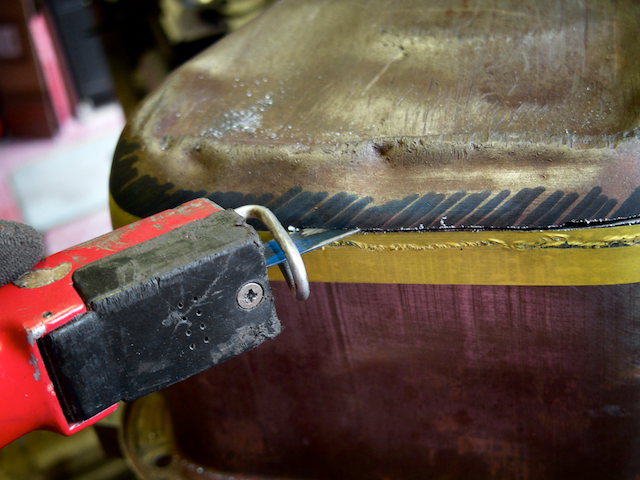

I cut about 20mm off the height based on the details in Guy's book. I ran some insulation tape around the perimeter as a guide for the air saw.

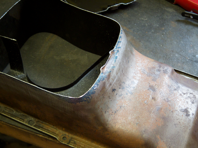

The rear edge near the drain needed to be flattened

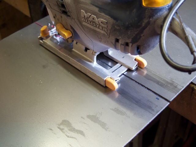

I opted for a 3mm thick base, which was easy to cut with a jigsaw

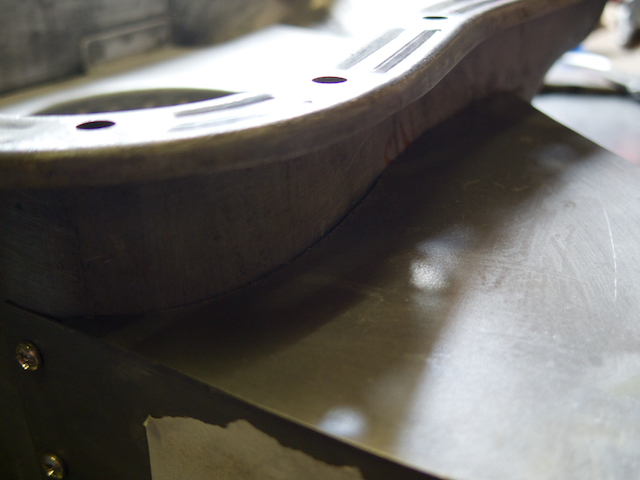

Checking the flatness and fit of the base

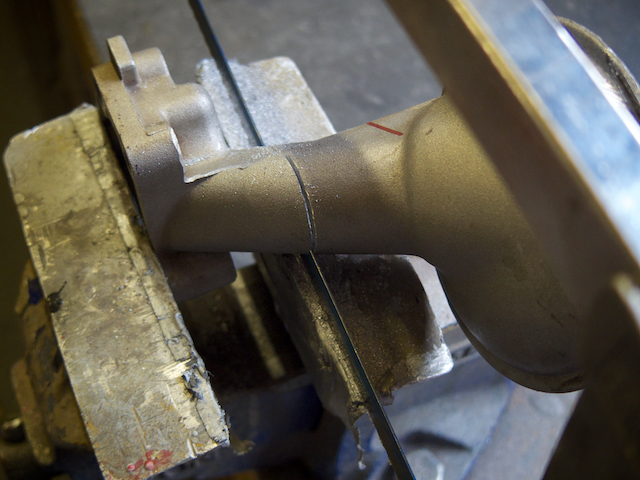

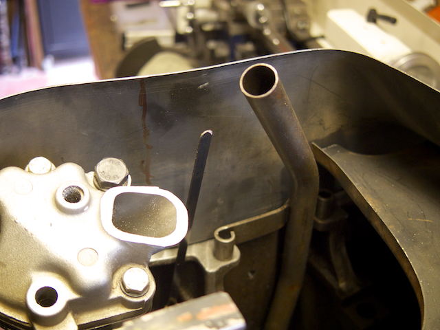

Figuring out how much to shorten the oil pump pickup
Cutting the oil pickup

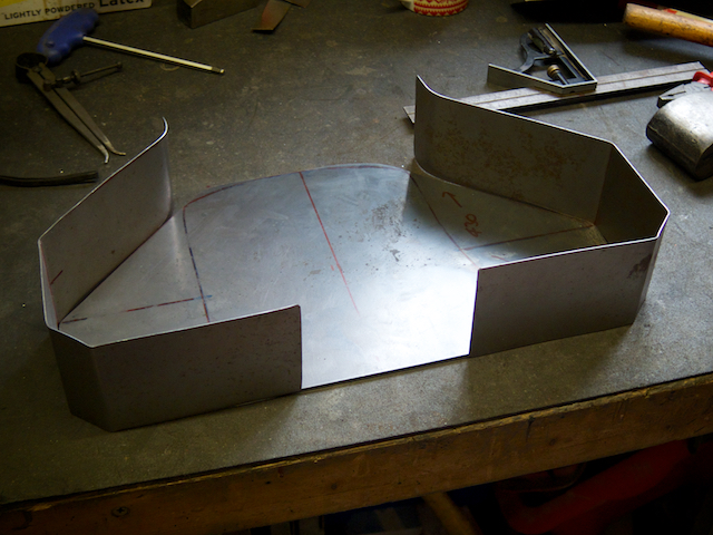

Planning and making up the sides. I went for 1mm steel as it was what I had
Both sides bent up
Both sides bent up

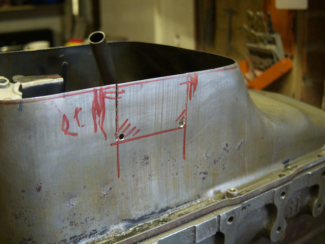

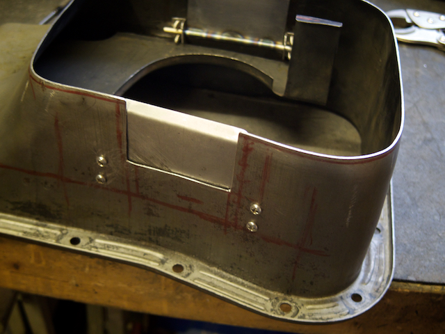

Checking the oil return and dip stick positions to plan the trapdoor positions
Cutting the trapdoor holes

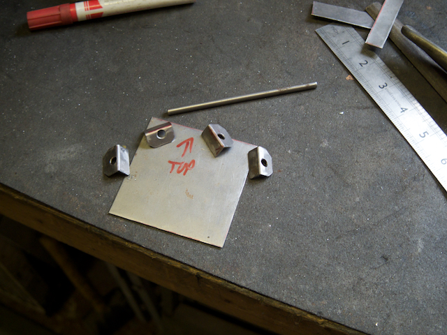

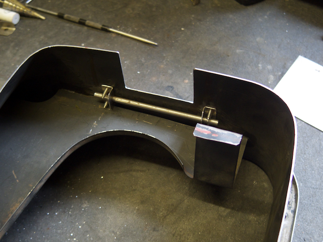

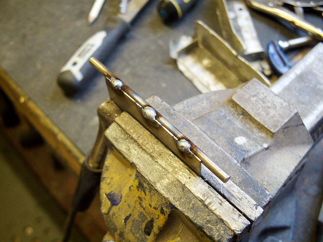

Making up the trap doors and hinge brackets. I opted for 1mm steel with 4mm down for hinges as that was what I had to hand.
I self-tapperd the hinges in so I could adjust the positions. I'll plug weld them on once everything is lightened up and free moving.
Welding the trap doors to the hinge pin
Both trap doors in place

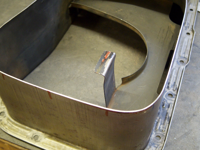

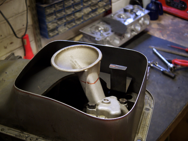

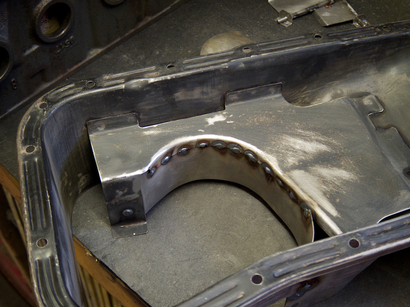

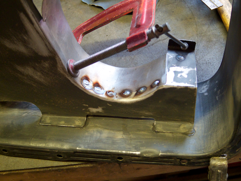

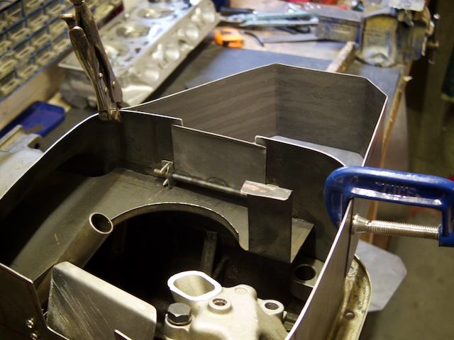

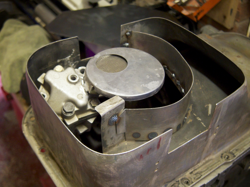

I made a bit more progress today by adding tacking the oil pickup in place and starting on the internal baffling.
Tacking the vertical baffle extension in place
Checking baffle and pickup height. I left an 8mm gap as Guy suggests.
Small section added to extend the top baffle, picking up on the trapdoor hinge mount. This will need a bit of fettling when I reshape the oil return tube.
Still need to drill some vent holes for the side boxes and make up the tops of the boxes, by have now run out of steel!

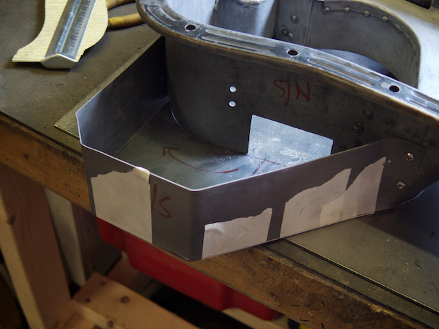

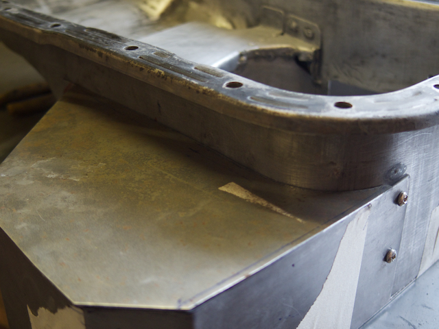

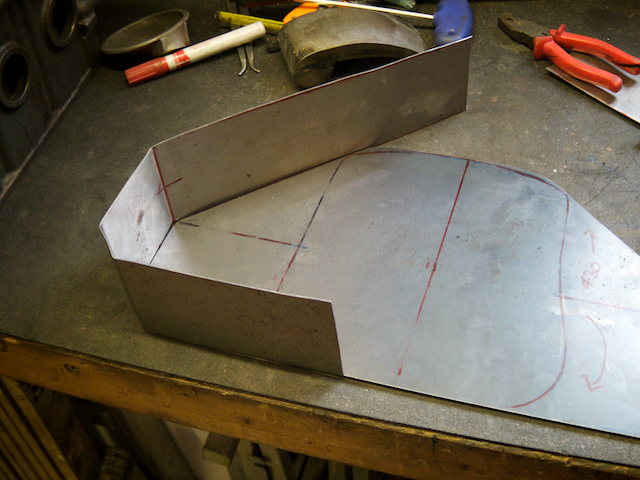

I spent today trying to finish off the fabrication of all the sump parts ready for taking together.

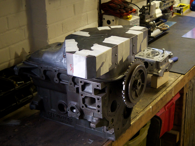

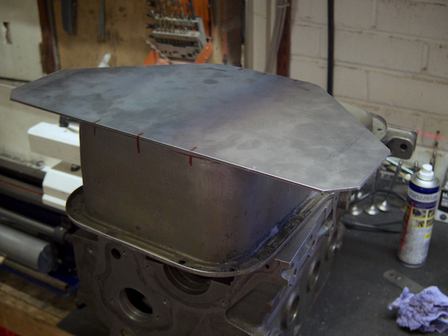

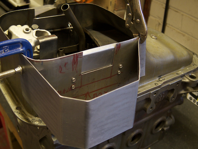

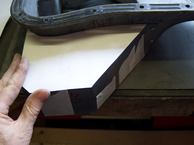

Self-tapping the wing side in place so I could make templates for the box tops.

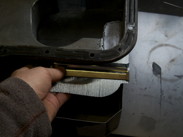

Cheap profile gauge was very handy for tracing the curve of the sump sides.

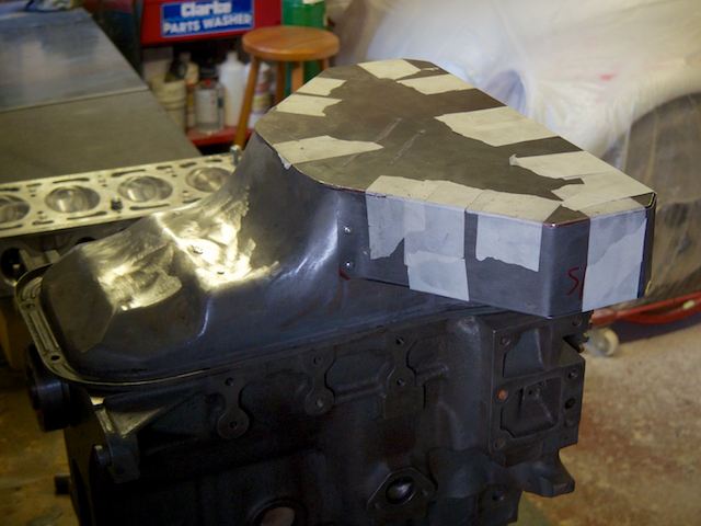

Refining paper template before transferring to steel
Checking the fit against sump profile
Near side is a lot curvier than the off side

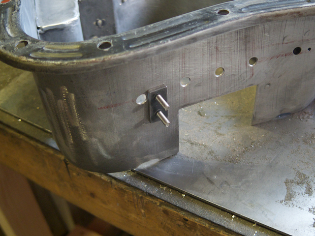

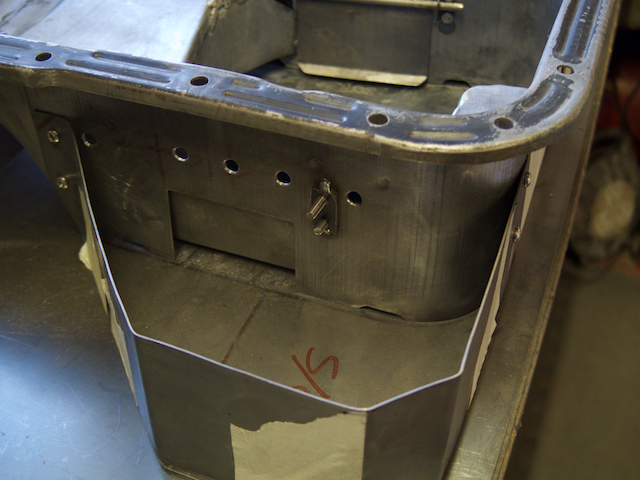

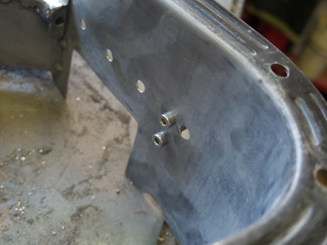

Air holes and scallops added. I decided to fix the forward trapdoor hinge mounts with M4 bolts to all them to be fitted after painting.
Threaded plate tacked in place
One of many trial fits back on the block
I now have pretty much all the parts made ready for prepping and tack up before welding. Still need to add the drain plug.
