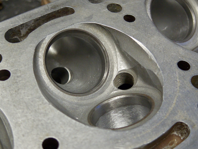

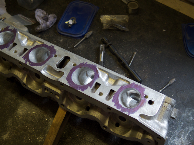

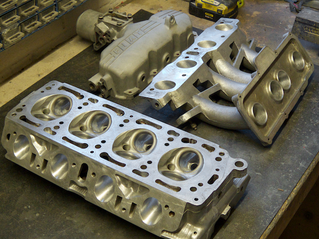

cleaned up head and inlet ready for porting
Hand and manifold.jpg (489.95 KiB) Viewed 82800 times
Head ports1.jpg (398.12 KiB) Viewed 82800 times
port matching 1.jpg (445.43 KiB) Viewed 82800 times
Finishing off basic plot reshaping sufficent for guides to be installed, before seat recut.
head prep2.jpg (434.51 KiB) Viewed 82800 times

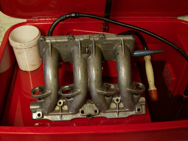

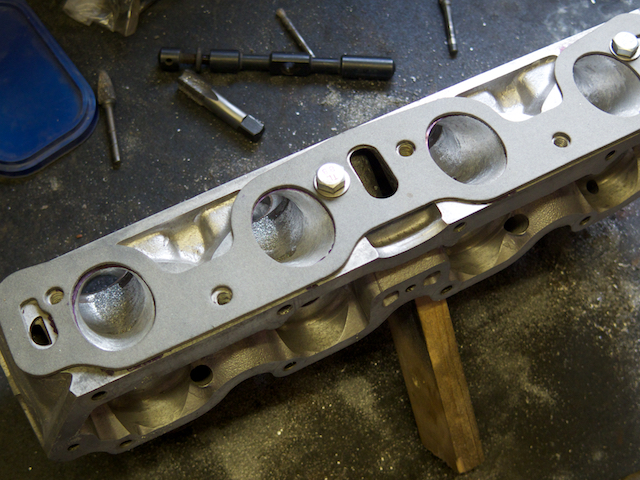

Cleaning up the manifold
Inlet cleaning.jpg (408.2 KiB) Viewed 82800 times

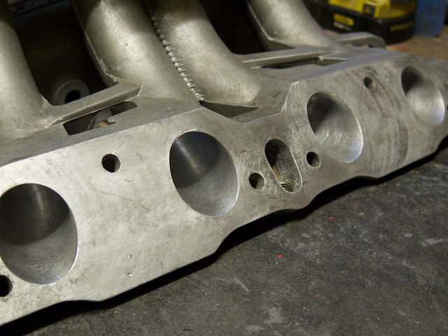

Matching the manifold ports
Poer matching 2.jpg (400.3 KiB) Viewed 82800 times
Almost ready for valve guides
Head prep1.jpg (455.26 KiB) Viewed 82800 times
Before seat cut.jpg (393.15 KiB) Viewed 82800 times

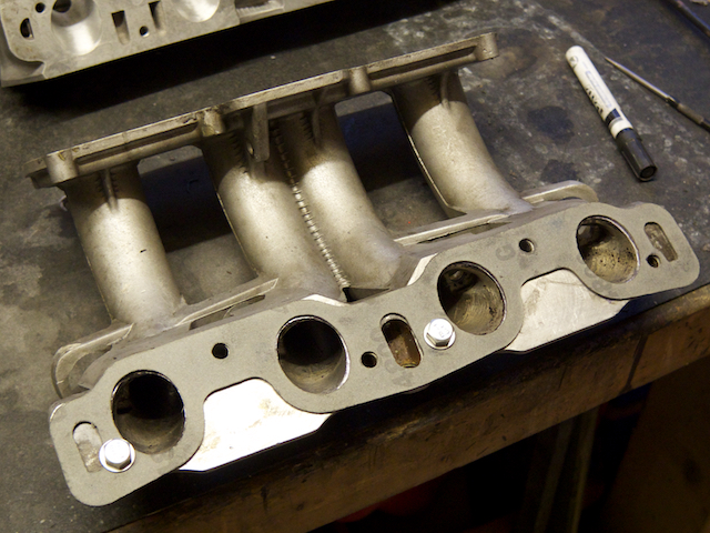

Manifold matched
Manifold matched
Runners cleaned up
Runners cleaned up

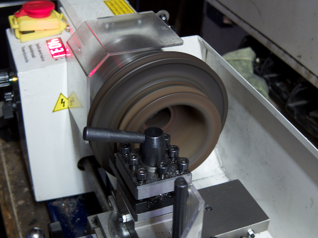

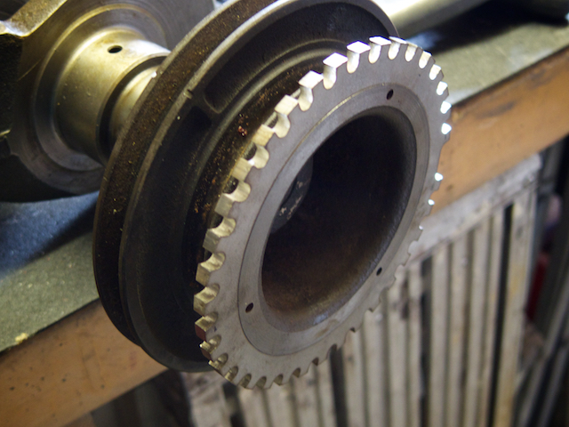

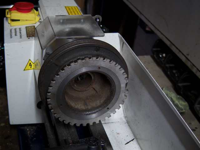

Over the winter months I discovered a lucrative sideline in repairing vintage hifi, which has funded a small 7x14 lathe and a press. So last week I played around with turning down the crank pulley to fit a trigger wheel for the Megavolt ignition and/or Megasquirt FI to replace the LE Jetronic. I also made up a valve guide insertion tool, and a jig for the press.

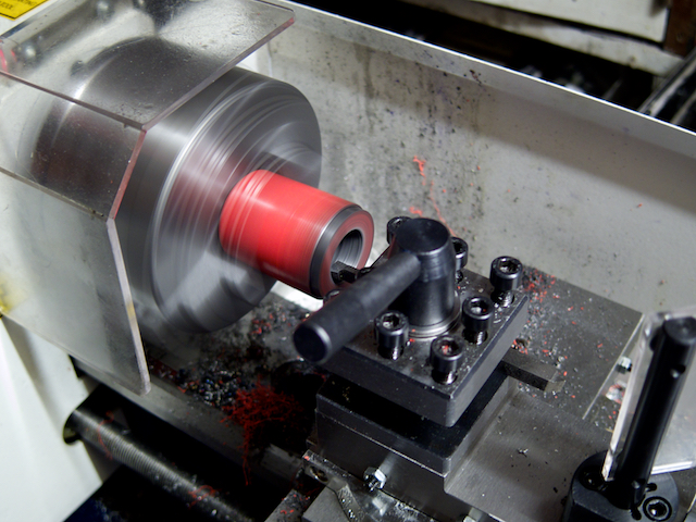

Turning down crank pulley for trigger wheel
Machining pulley.jpg (337.07 KiB) Viewed 82800 times
Test fit of trigger wheel
Trigger wheel3.jpg (334.83 KiB) Viewed 82800 times
Trigger wheel1.jpg (347.86 KiB) Viewed 82800 times

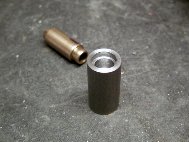

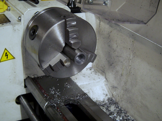

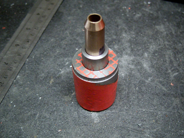

Making the insertion tool.
Insert tool turning.jpg (385.6 KiB) Viewed 82800 times
Tool engages with the shoulder of the guide and also acts a depth stop
Insertion tool.jpg (374.08 KiB) Viewed 82800 times

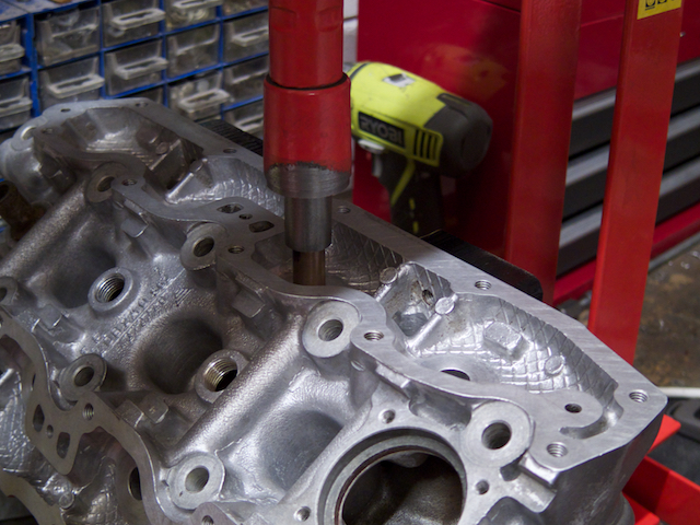

Boring the foot of the press to accept guide insertion tool
Machining press foot.jpg (408.68 KiB) Viewed 82800 times
Insertion tool and guide in modified press foot
Insert tool2.jpg (432.88 KiB) Viewed 82800 times
Testing the alignment of press jig
Test press.jpg (405.12 KiB) Viewed 82800 times
