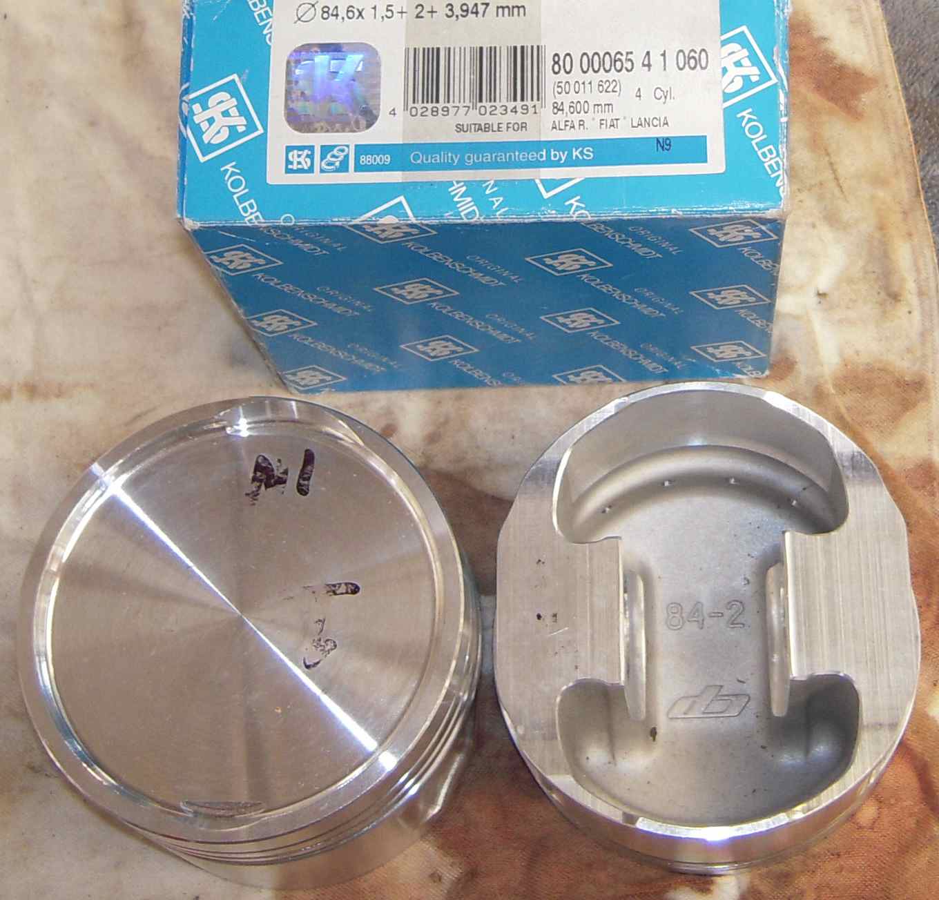

The pistons are CP forged, I'm hoping get around the 7.5-1 comp. with them.

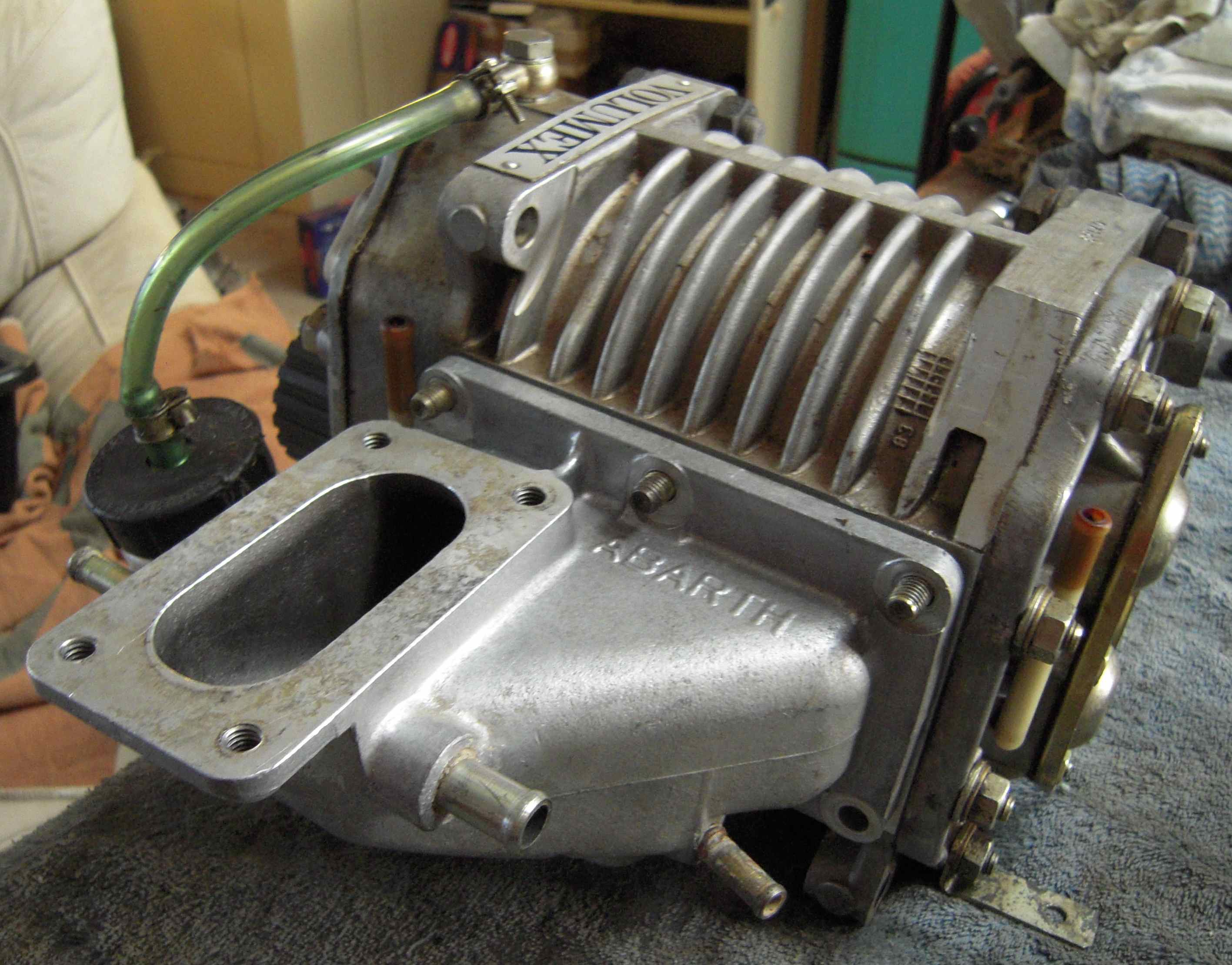

The downdraught carb. manifold is the one I'm thinking of using a 40 dcnf with,(fellow member Eric may recognise it and have some suggestions), but I'm not sure if the carb. orientation is correct for RWD.

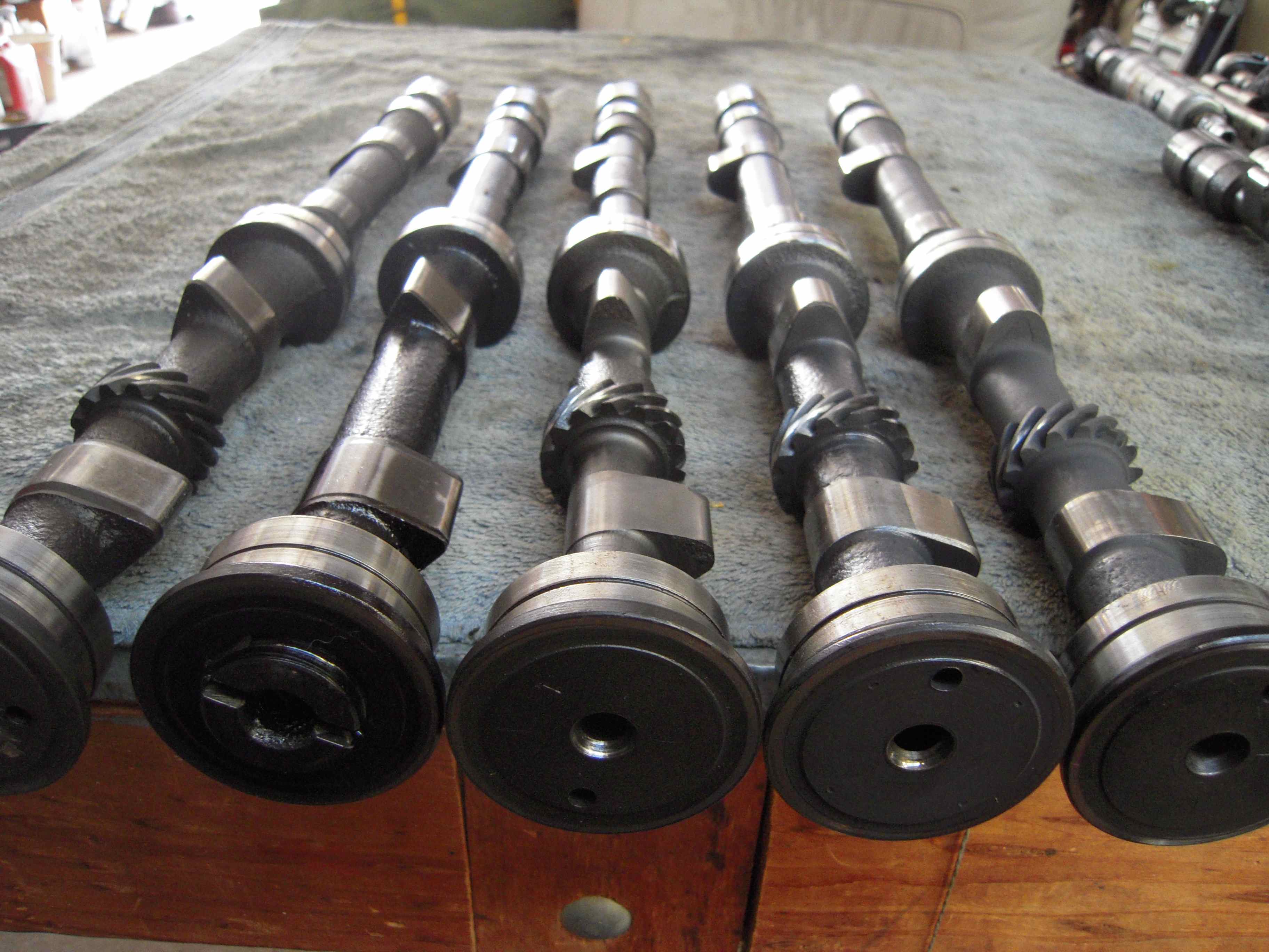

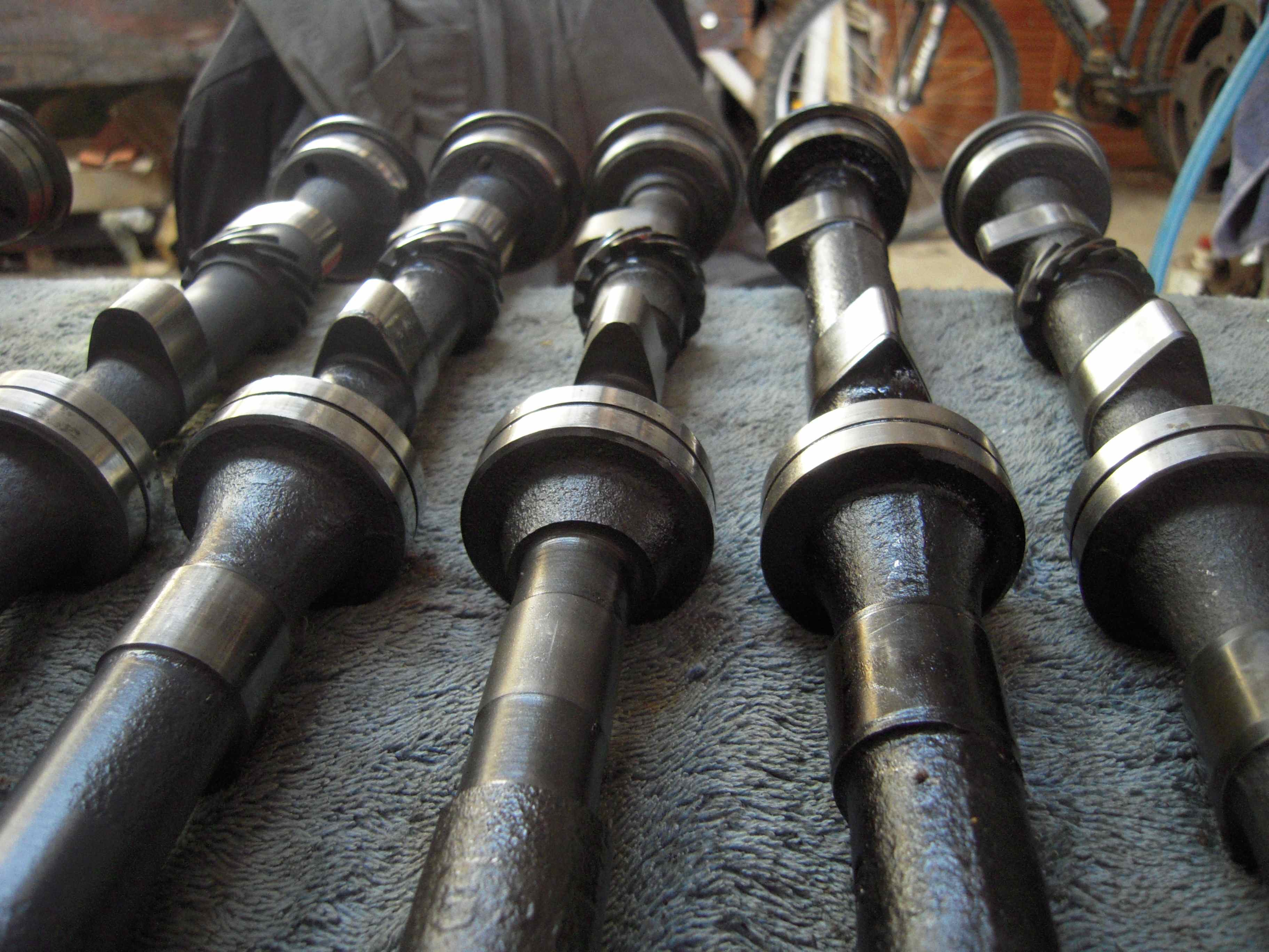

The Ex. cams are, front to camera is Right to left ,1608 bc 66/26, STD VX , a very bad n/a cam that did actually work well in n/a race motor, but poorly made.
A locally produced built up cam Wade 137 Grind, .410" lift of 70/30 but only runs with valve clearance of .009" but very well made.
A locally produced built up cam Wade 132 Grind, .410" lift of 80/50 but only runs with valve clearance of .009" but very well made.This cam was excellent in a n/a race engine .
The Ex. cams are, rear to camera is left to right , 1608 bc 66/26, STD VX , a very bad n/a cam that did actually work well in n/a race motor, but poorly made.
Obviously the Wade 132 is out.But I need an ex. cam with gear drive. So I'm still looking.
