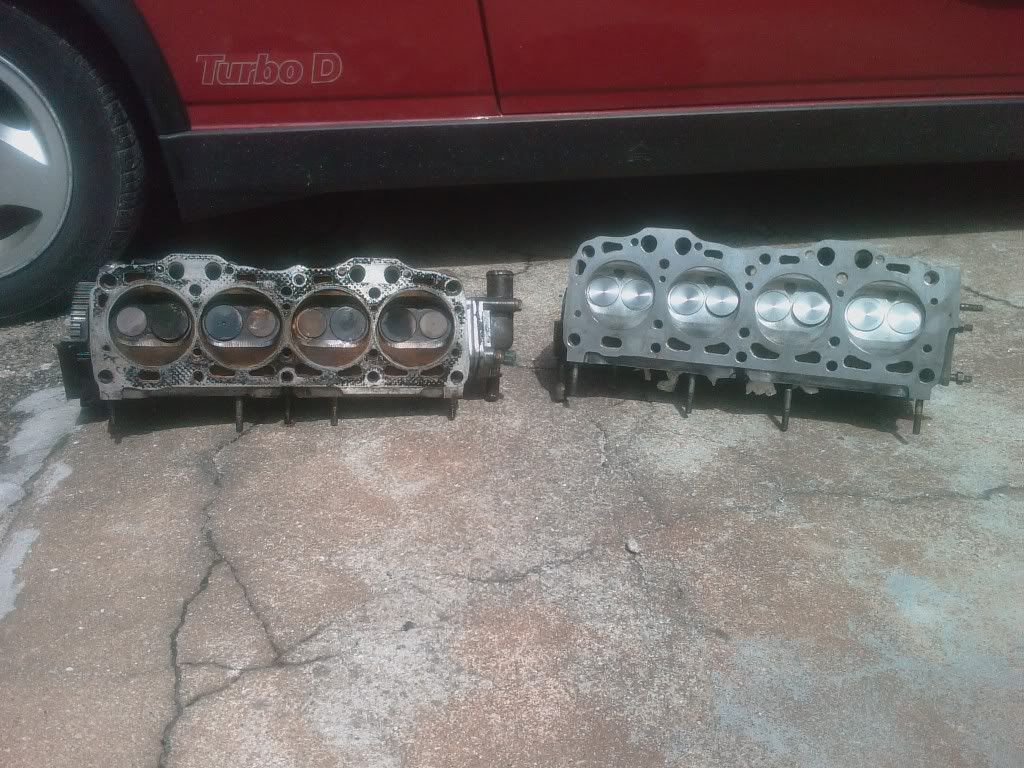

I bought my UT with this engine already. The previous owner stated it was from a Lancia dedra 1.6, wich i doubt it. So after looking around on the web/eper, etc, i was unable to find the car model from which my engine came from. Any help would be appreciated!
From what i've searched online, the block seems just like the X1/9, and the head looks to be from the tipo 1.6 SOHC. The inlet valves measure 39mm (afaik), and concerning the looks of it, it is very similar to the 1.4 UT on the outside. Same size and everything... Oh, a bloke also told me it could probably come from a regata 100s, but...
the head that mates with this block:
1.6 on the left, 1.4 UT on the right
PS: you can also read on the side of the block the following numbers:
335.A1.000
8044926
thanks

I regret that even my Fiat dealer cannot trace that block code or engine number.

John, sure, but I don't see the connection betw the numbers on your engine and in that thread.
If the engine code is right it should show up at Fiat, but maybe it's some foreign import.
The ribbed block (criss-cross) aux d/s pulley tells me it's MkII Uno/Punto maybe Tipo, not X19. Beyond that bore and stroke might help ID.

Apparently, some folks in a Portuguese Fiat forum helped me to identify the engine. One of them searched on AutoData (Don't know which version) and the code corresponds to the Lancia dedra 8v spi.
Dedra SPI>
Dedra MPI
Now i my goal will be to find some spare parts! Thanks for the help Guy!
